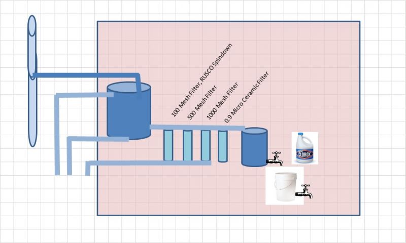

Here is one for rain water used for drinking. I don't like the ultraviolet for last stage because you can't tell when it stops working. So bleach is the guarantee final for drinking.
A 1 micron filter will remove most bacteria and cysts.
You could do the 1000 Mesh (15 Micron) Russco to trap sediment and then the 1 or 0.9 Micron Ceramic. If the 1000 mesh starts clogging up then add the other filters upstream until your happy with the cleaning frequency. You can use less filters and clean/replace them more often or more filters and clean/replace them less often.
