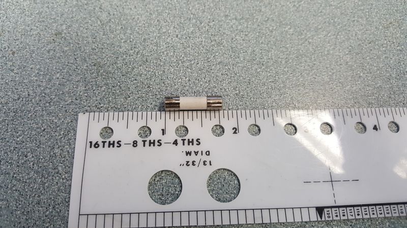

 Back up in the North Country in my sweet cabin. Solar is working great, phoebes have built a nest on my new front porch rather than over my back door, which is considerate of them, since I'll be working back there this month.
 But the Dometic propane fridge has blown a fuse, and I'm having a heck of a time picking up a replacement. Hardware and auto parts stores don't have it. Nor do the first six RV shops I've called. I have an email in to Dometic, but I'm thinking that might take a while. Can anyone point me in the right direction? 3A 125V slow-burn glass fuse 1" long (that length is the problem).

 Is that a Dometic (Servelk) residential propane fridge or a Dometic RV fridge?  Also, what fuse is it? The amps and volts don't mean much without knowing the type, such as an ATC type auto fuse with two blades or a tubular glass fuse. If tubular glass the length is important. There should be a number on one of the metal end caps if it is a tubular type.

 RV fridge. Tubular glass fuse. Twisted wire filament. I'll check the number when I get home. Thanks!

 Another question... what circuit does the fuse protect? The fuse could be a 125 volt fuse but could be used to protect a lower voltage circuit. In which case a lower voltage value fuse could be subbed.

 Hi ICC Protects the "refrigerator control system" which is connected to the 12V power supply. So yea, I'd think a lower voltage would work. What do you recommend? Right now I'm having trouble finding anything the right length. They all seem to be 3/4" (20mm) or 1 1/4" (30mm).
 On a related note: I talked to a helpful guy at NAPA who said I could put in a fast-blow fuse if I had to.
 Hi old243 -- Thanks for responding. I called two Napa stores and AutoZone, and no dice. Do you have the name of any electric wholesaler? Not sure where to look for those. No idea why it blew. Worked when I left last fall; didn't work when I tried to start up this spring. Identified blown fuse. That's it. I'd like to try replacing the fuse before I try to find a large appliance guy who can service a propane fridge.

 Call an industrial electrical distributor, preferably one that handles Allen-Bradley. We use fuses like that in a lot of control systems. I probably have 10 of these smaller ones in my desk right now and we have boxes of the 8AG (the one inch ones) in our warehouse. It does not matter if it is glass or ceramic as pictured.
 Also it does not matter if its a 125 or 250 volt fuse, that just shows the MAX voltage that is allowed. A 250 will work just as well. Its the amps that is important.

 Thanks, Tim. Looks great, right size, except the site says 5A and up, whereas I'm looking for 3A. Anyway, I'll give them a shout.

 Had a nice chat with a Dometic dealer down state who gave me a phone number to Dometic parts. That did they trick. They're mailing me the fuse today. Actually, I bought 2 (!).

 Toyota -- Thanks for taking the time -- alas it is too short. Need 1" / 25mm (this one is 15mm). I actually have messaged that seller to see if they have the size I need.
 I really have scoured amazon.com and eBay. Doesnt' mean I didn't miss something, but no luck yet. I even have the part number now, but no dice.
 Fuses from Dometic arriving Tuesday. Fingers crossed!

 Hokay. Received the fuses yesterday afternoon (a day late -- thanks UPS). The first good news is that what I actually got was a pack of six fuses--actually two packs of six fuses--so I have a lifetime supply. They are indeed 1 inch long.
 So I did a careful clean out of the access area of the fridge, plugged the fuse in and turned it on. Light came on in the main compartment and burner fired right up. Freezer started chilling within minutes.
 I was a bit worried about the main compartment, which showed little signs of cooling within the four hours the manual says it takes, hovering at around 60 F. But by the time I went to bed last night it was down to 46 F and this morning it was in the 30s back by the fins, so yeah!

 So what they sent was Bussman 3A AGX fuses, which are, of course, available everywhere (and not what the manual calls for). Anyway, it works.
