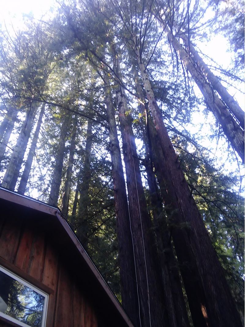

I have the same problem. My plan is to mount panels at the top of a tree, even ran a rope and pulley to get stuff up. Just haven't found anyone brave enough to work up there. I'm needed at the bottom, of course, to load the stuff.

Ok, I have some practical information to share on the topic of solar in the shade.
First, my setup. I have a 6-panel solar array (configured 3x2) using REC280TP panels for a nominal 88.47V and 1230W @NOCT. I run these panels through a Midnite Solar "The Kid" (MPPT) charge controller, charging a 36V, 210AH AGM battery bank. The panels are not oriented "ideally" on either axis, rather are oriented in the simplest manner, fixed to the south-easterly facing roof of a small cabin.
What does this have to do with "Solar in the shade?" Unfortunately, during the summer these panels are in partial (or full) shade all but ~1hr/day. Because of the TwinPeak technology, these panels can generate more electricity with partial shading than traditional panels. However, in full shade, these panels are no different than any other similarly spec'd solar panel. In full shade at mid-day (on a sunny June day), I have seen these panels generate 268W. That is ~22% of NOCT and ~16% of their STC rating.
Because of their orientation (and possibly other factors such as low ambient indirect light due to nearby heavy shade), during direct sunlight I have not seen this array exceed 680W. That means this array generates up to ~39% of its "direct sunlight" capacity when in full shade. But, I should note, full shade is different than "deep shade". Although the array is in partial or full shade the majority of the day, there is sunlight on about 30% of the surrounding area at any given time. You will certainly see different results with an array in "deep shade" where there is almost zero direct (or even filtered) sunlight in the surrounding are.
On that sunny June day, the array generated nearly 1.8KWh of electricity, with about a third of that occurring during the ~1 hour of direct sunlight, one third occurring during partial-sunlight and the remainder occurring in full shade.
