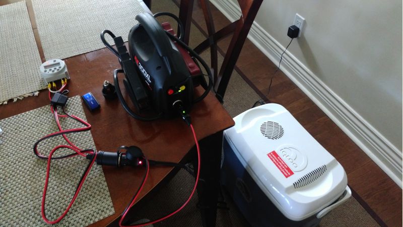

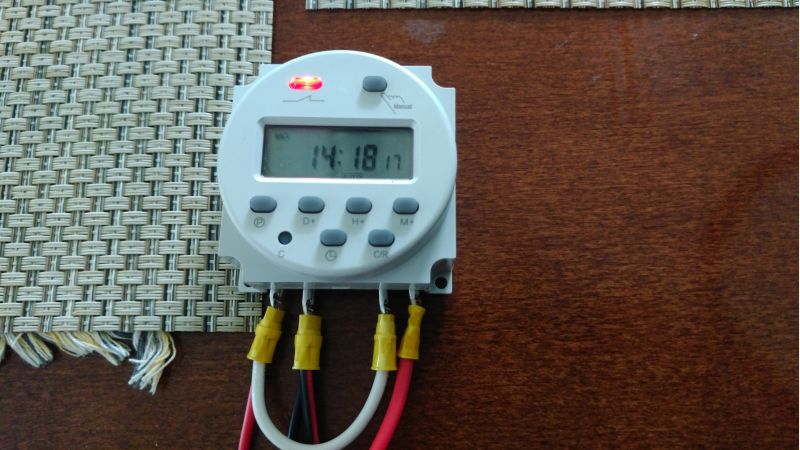

I'm sure this has been done here before but just wanted to share a little project I completed over the weekend... Wiring up a 12v digital timer for our Igloo 12v cooler.
It has multiple settings and fairly easy to program. The cooler is very well insulated so no need to keep it constantly running and sucking the life out of our solar setup.
This might be useful for weekend warriors such as ourselves. Total cost around $20
