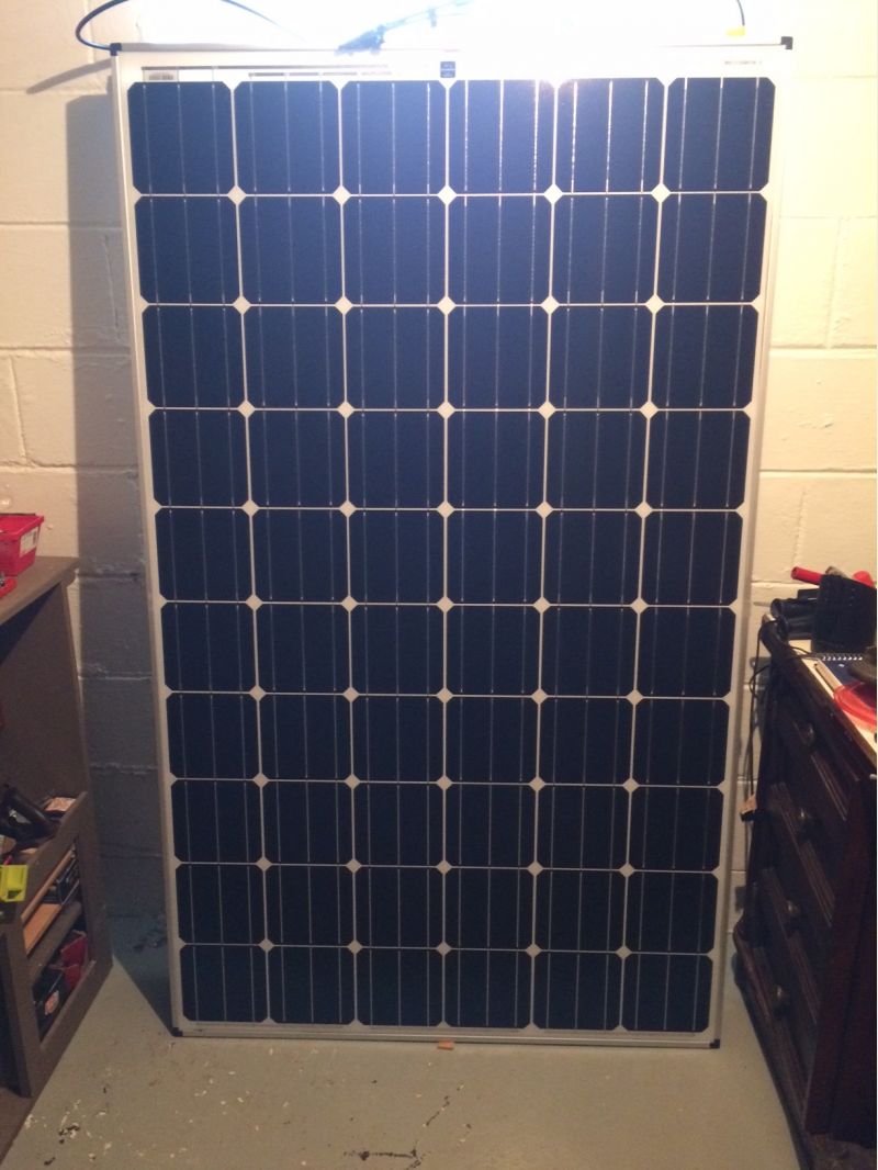

 Still waiting on a response for 265 watt panels I posted previously on.

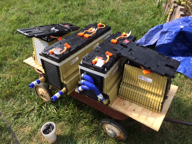

 Took  the beast apart...

 Don't forget. Make sure you're not grounded when you work on those batteries. Ie. stand on a piece of wood. Not the ground. Rubber shoes. Latex or ... gloves.
 Get those bus bars off first thing. I imagine you did that already. Once its all 48v or less its way safer.
 And ditto. Slow but steady wins the race.

 Creeky-First thing I was thinking was to separate so that at least there were individual packs should a mishap occur.  I pulled off the top plastic and removed bus bars early on... (very carefully)
 I did have rubber shoes on.  I was very slow moving as I pulled things apart as I remember in one video the fellow said should you drop a tool on a pack it will be a very bad day.  I don't even like keeping the plastic covers off ;)
 Actually I was surprised that it did not take much to dismantle,hardest part was getting the module in the truck to bring home.

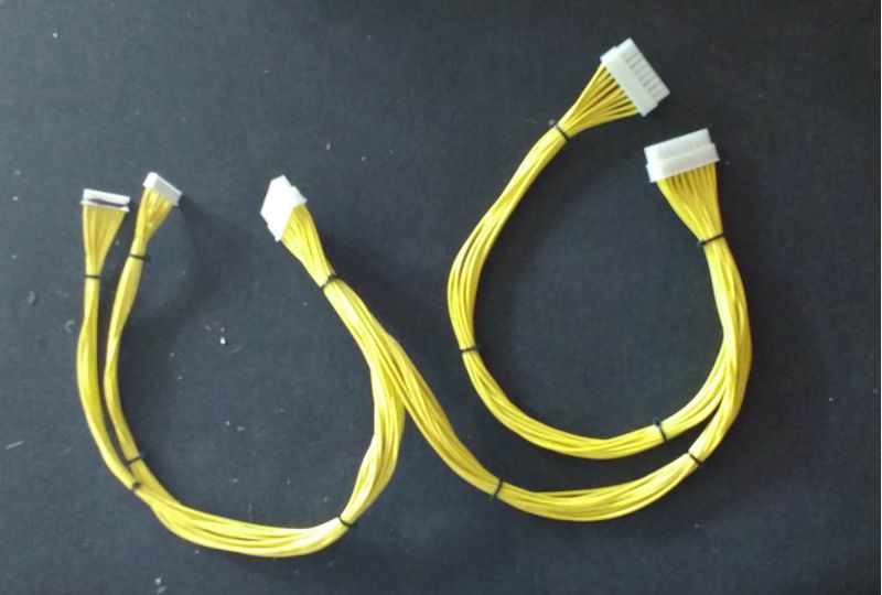

 Here's the custom wiring harness we're making for the Volt battery packs. Pretty sweet. Ties all the cells together for a stronger better system.
 this one is on its way to Lakeside Ontario.

 Nice Creeky...
 Taking advantage of the pin connections that are already in the battery itself.
 A few questions... Does the harness as shown tie in 3 48v banks?
 Is your plan to then use this to tie into the BMS that you are also working on?

 My harnesses tie 3 48v modules together. So Ontario will have room for another module. I have a 2 module connector but its more for expanding the 3 module harness. And the price is the same. So ...

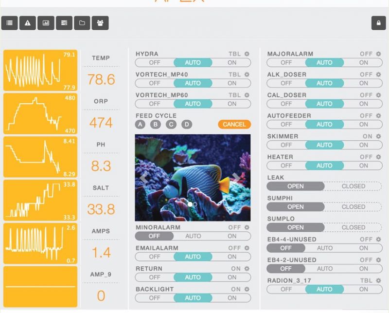

 I recently purchased an LED aquarium light from a fellow here in the US. A little more expensive however people were willing to purchase due to his ability to refine his product to meet their needs.
 He started by appealing to a niche group similar to yourself.  Basically listening to what the hobbyist were after and providing exceptional customer service.  He was able to quit his day job and continues to build quality LED lights and provide exceptional customer service.   I am always to happy to hear of these type of successes by individuals keeping their eyes open and trying new things such as yourself.
 When I hear responses like this well...

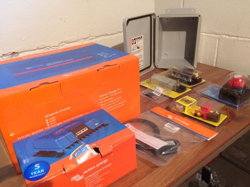

 | # Posted: 6 Sep 2017 03:19pm - Edited by: bronco_ed Reply
 Sold the last of the volt batteries, now I can order another piece to the puzzle!
 Solar Panels             x
 3 /Sun Module Plus SW 270Mono  (.65 per watt!)
 Solar Controller        x
 1 /Victron BlueSolar 150/35 MPPT
 Batteries                  x
 2 /48v 47A 2k volt modules
 Inverter   (Most likely Victron Energy)
 Combiner box
 Fuses
 Wires
 Connectors

 Fun getting presents in the mail.. Inverter and Blue tooth dongle is off list now.
 Only a few more items left to purchase.
 Combiner box
 Fuses
 Wires
 Connectors

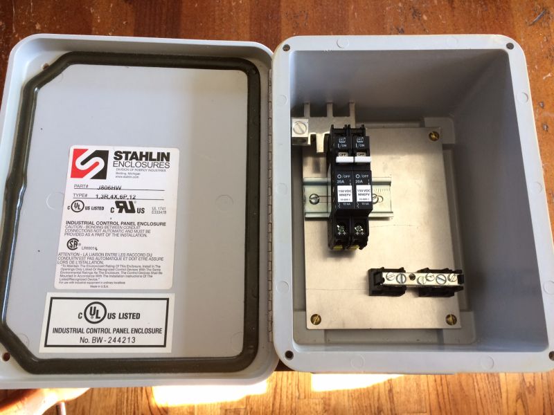

 Would this combiner box work well with the components I have.
 Ontario lakeside does not mention to much on the combiner box.
 Would rather have a non conductive box,  smaller in size.
 I don't think I'll ever need more than 2 strings.  20amp
 I see another a similar combiner box with fuses on eBay, however it ships from Hong Kong.
 http://solarpowercombinerbox.com/dual_fused_solar_power_combiner_box_escb_df.html
 I see folks making combiner box with tab type auto fuses...  I have plenty of them on hand up to 5-50 amps.  Anyone make one similar?
 Thanks!

 I use the midnight solar boxes as I very much like their circuit breakers.
| bronco_ed Member
 | # Posted: 17 Sep 2017 07:34pm Reply
 Thanks yes I was looking at them (prewired).  I was hoping to find something a bit more compact and in plastic... (ha first time I actually wanted something made out of plastic)
 After looking a bit more I do see they make a "baby box"  I would have to buy all pieces separately and assemble.
 (Which does not appear to be complicated.)
 Or buy the components and house in a small plastic unit that I was hoping for.
| ICC Member
 | # Posted: 17 Sep 2017 08:27pm - Edited by: ICC Reply
 Quoting: bronco_ed I was hoping to find something a bit more compact and in plastic...
 Why?  Metal has been used for decades for high voltage service panels. Completely safe when designed and used properly. Never had one rust myself.  I believe the midnight boxes are aluminum. Made in USA. The Baby series are indoor use only I believe. Their combiners can be used outside, unprotected from weather.

 Ordered the marine fuses, busbars,switches,etc.  So I only need proper wire,connectors and determine what I want to do on combiner box.
 Not much to a combiner box so there are options.
 I want to enclose similar to Ontario Lakeside set up however I may investigate a couple areas with quick disconnects.  Battery will not be in same enclosure but close by. The set up will be easy to hide/ tote away... aside from panels of course.
 Almost there with components.

 I think I am finding narrowing in on components for the combiner box I am interested in for my setup...
 Here is something similar:
 http://www.ebay.com/itm/291627541370   I like this but... it is a bit larger than I wanted.
 The enclosures are made right here in Michigan.
 Possibly order the compact midnight solar busbars, breakers,etc.

| bronco_ed Member
 | # Posted: 3 Oct 2017 01:13pm Reply
 Just need to add wires ;)
 Midnight solar components... 20 amp breakers..
