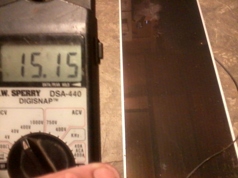

Quoting: paulz . I don't get much sunlight but the controller does show 13-14 volts at times if disconnected from a battery Been following your post for a couple days. I have two of the old HF setups at least 6-7 years old. I also did like bucky did and got a morning star controller. I use the original controllers as power hubs in the cabin and shed. Everything that came with the kits are still working. When I read that you were only getting 13/14 volts when disconnected from the battery, I took this picture of one panel hooked to a multimeter, laying on the floor. The only light source is a 4 foot 2 bulb fluorescent light fixture on a 9 foot high ceiling. You may have smoked the controller by disconnecting the battery with the panels still hooked up. Try testing the panels when not hooked up to anything. My panels still put out 20 volts +/- when in real sun light. You may have a dead or dry cell in your battery.

Quoting: paulz Isn't the controller not supposed to drain the battery if the sun isn't shining? Maybe it's faulty, its about 5 years old. Not sure about the controller, but the old HF panels didn't have a diode to prevent backflow at night. I don't remember exactly how I did it, but there was a common mod people did to add a diode.
