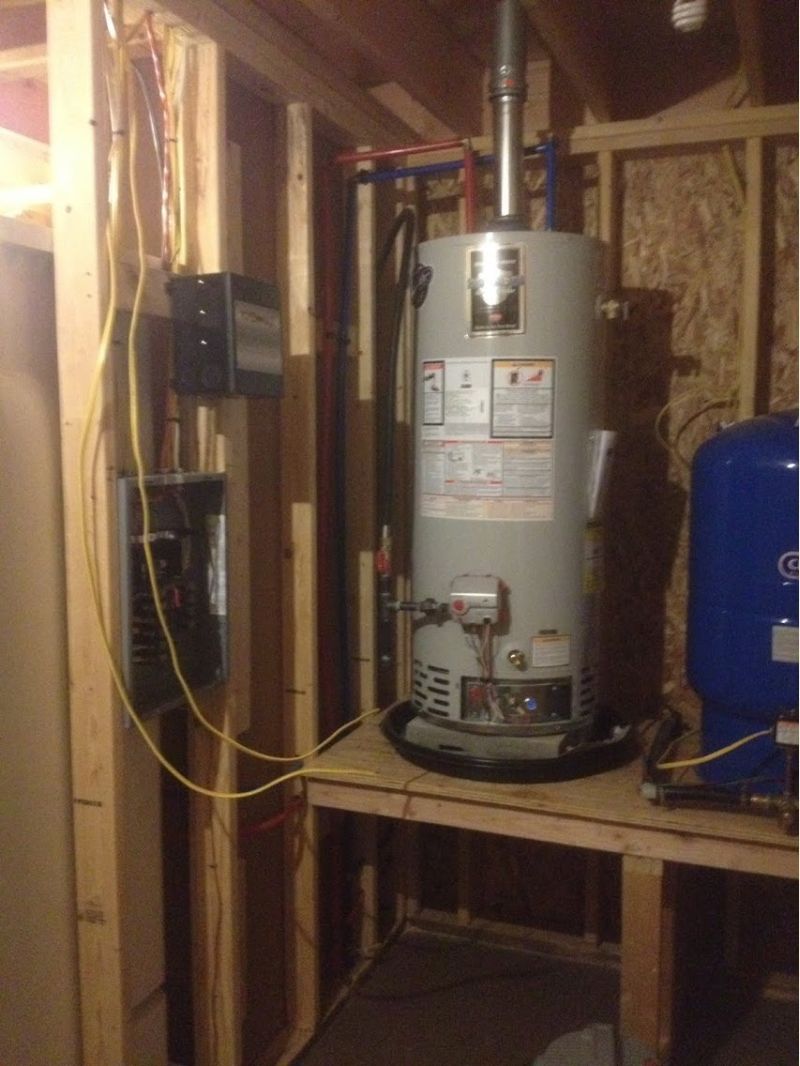

I currently have an off-grid vacation cabin with a conventional water setup (see attached pic):
Deep Well (220v pump), Pressure Tank, and propane hot water heater (no electric). We have it all plumbed so that it is easy to drain everything down via gravity. (No worries about having to blow the lines out)
Hindsight being 20-20, I think I would have done things differently. But, at the time, we wanted to prepare for the chance that we might get electric utility run up the mountain...
Obviously, since I have a 220 pump, I need to run the generator to take showers and otherwise keep water in the Pressure Tank. I've been running this way for 2 years. However, it is getting increasingly annoying to have to walk out and start the generator every 4-5 toilet flushes just to pump the pressure tank back up.

Replace the existing pressure tank with a bigger one?
SCSJeff
# Posted: 11 Sep 2017 09:11pm
I did think about that. The current pressure tank gives me about 5 flushes (1.2 gpf). If I can double the size, it's still only 10 flushes though (not counting any other water use) and definitely not a shower without firing up the big beast still...

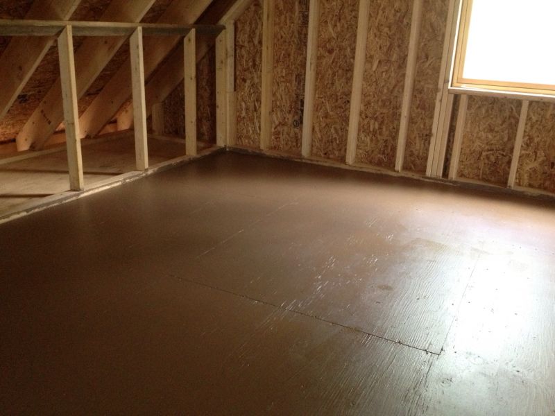

Attached are pics of the eves and the ceiling joists below that I'm debating for the water storage. I'd have to be able to fit the tank (or tanks) between the knee wall studs. But, I think I could probably get at least 100 gallons of storage up there. Is it possible to use gravity feed and have a shurflo inline at the same time? For example if the power is off, will gravity feed still work for flushing toilets and washing hands? Or does the pump have a check valve in it that won't let water flow through it?
Ideally, I'd like to keep the investment in equipment that I already have. So hence that's why I'm thinking about options to work with/around the setup rather than replacing it. For example, I really don't mind the standard hot water heater. Other than taking up space, it only takes about an hour to heat the water and it's relatively bullet proof and easy to drain.

Looks like a palace up there. And looks like at least 2x8 joists, maybe 2x10. I would think you should have no issues with 100 gallons of water unless the joists are rotten or something. Would spread the weight if you added a sheet of 3/4-inch plywood under the tank(s). Poly tanks come in various sizes and shapes (google polyethylene tanks) but probably the cheapest solution is the local surplus store that will likely have poly barrels of various sizes. Spacing on the kneewalls looks wide enough to fit most anything into that space behind them.

Just got back from the cabin. Apparently the amount of room in those eves is not as large as the picture makes it look. Took some measurements and I can't fit anything worth while behind the knee wall. However, I'm really liking the idea of having gravity feed for washing hands and flushing toilet. So, I may just set a 100+ gallon tank in the living area. I have one spot near the top of the steps that is just kind of dead space. I could set it there and maybe set or build a table top over it..

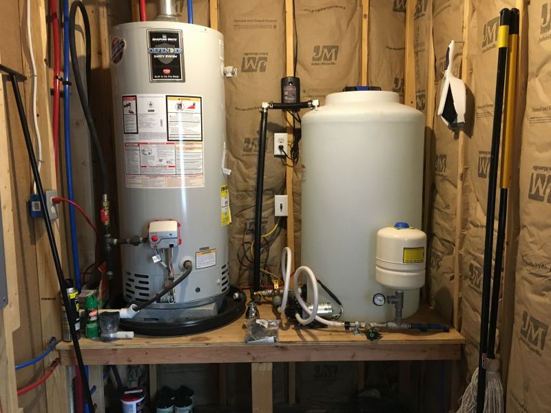

Update: System Completed!
Replaced Pressure Tank w/ Tractor Supply 65 Gallon holding tank. Installed manual switch for 240v Deep Well Pump. Flip switch to fill tank (when big generator is running). I do have to fill it twice as I also have to run the Shurflo to fill up the hot water tank and pressurize the lines. Total time about 15-20 minutes.
Installed small pressure tank (instead of Shurflo Accumulator, it was half the price and holds more water as well)
Shurflo is quieter than I expected. With small pressure tank, can run the faucet to wash hands, etc. without immediately kicking off the pump.
Shurflo runs off inverter with no issue! Although, I do usually have the small inverter generator running while showering just to save the batteries.
Replaced shower head with low flow shower head.
In addition, this setup will save me having to keep a generator running and electric heat tape around the well line coming into the cabin during freezing weather. (I have a curb drain that I can drain down the well line with after filling the storage tank)
Got a workout this past weekend. From Friday night to Sunday afternoon, we had 6 people. 6 Showers, as much toilet flushing as necessary and did dishes twice. All without having to fire up big generator! Grant it, we used about all the water by the time we were leaving. But, I'm super happy with the end results.
Thanks for all the help/info from this forum!
