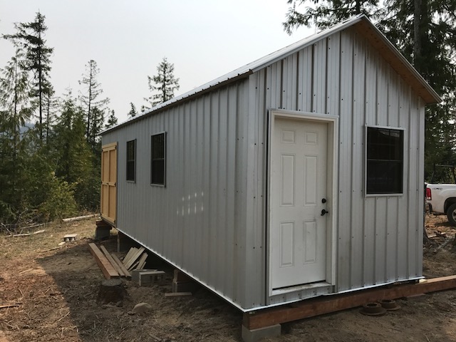

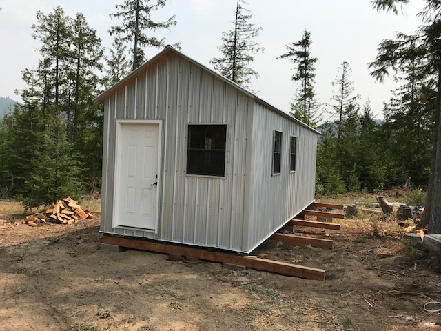

 I'm looking to heat my 10x28 cabin in NE Washington for short winter trips. Mainly Oct-Nov hunting season and winter weekends with the family. We're at about 3000' elevation and regularly see sub 0 temps in the heart of winter. I'm not sure yet, but estimate 20-25 heating days a year, possibly more as the kids get older and start hunting too. I'm working on insulation, so that should be done soon. R-13 roof and walls, floor un-insulated.

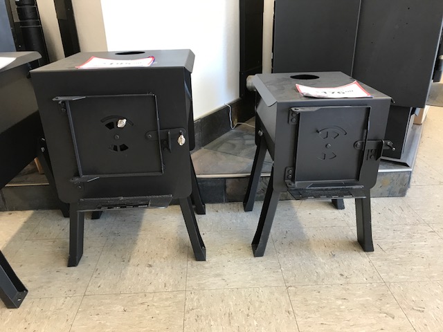

 I'm trying to decide if I should go with the original plan of a wall tent stove or a modern epa wood stove. The tent stove is cheap at about $225 out the door but will require a heat shield for clearance while still taking up more room than an EPA stove and be far less efficient. Dead standing firewood is free and plentiful but does require work to harvest and split.
 An EPA stove like the Hi-flame Shetland 800 Sq ft is pretty much better in every way but cost about $625 shipped, and that is with a great deal I found online. They are over $900 locally. Another option but a little bigger is the Pleasant Hearth 1200 sq ft locally for $550 OTD.

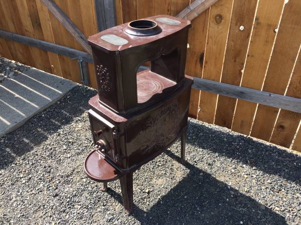

 https://spokane.craigslist.org/for/d/wood-stove/6298248967.html

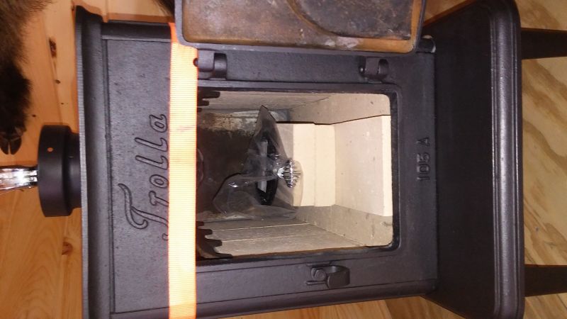

 This one is close to you. Its Trolla, probably 105A. Its almost like Jotul 602. That stove is lined with firebrick and takes 6 inch pipe. For 80 buck its a deal. Clean it with brush and paint it and its like new. They weremadein Norway. I have the same and cant be more happier for my 10x20 cabin.

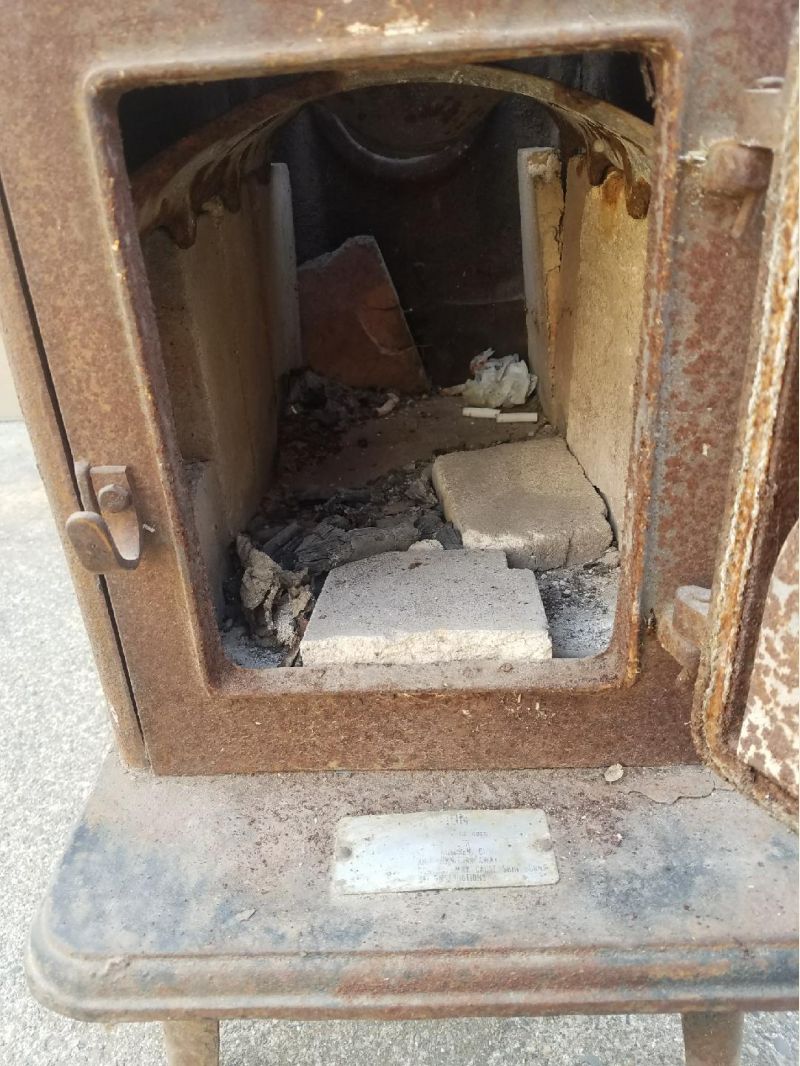

 Quoting: xtolekbananx This one is close to you. Its Trolla, probably 105A.
 I saw that but couldn't figure out what it was. I assumed for that price it wasn't in any kind of shape to burn in. After seeing yours and a quick google I'm pretty sold. I'm out of town but I'll get my wife to go grab it.

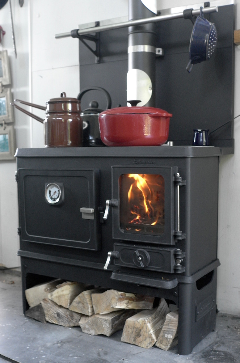

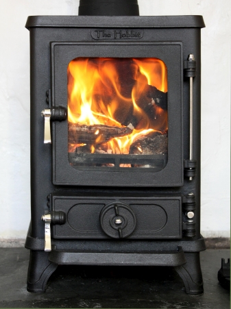

 [img=null]null[/img]http://salamanderstoves.com/product-category/stoves/
 Although they are not going to be price competitive with some of the used & local small stoves being discussed, the link above gives details of some really neat, tiny space wood stoves available.
 I have one of their Hobbit stoves, and their new Range/stove combo really looks interesting.

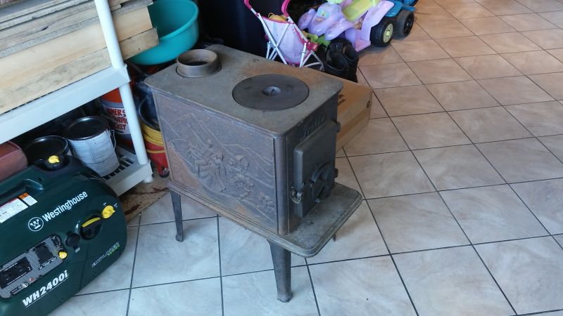

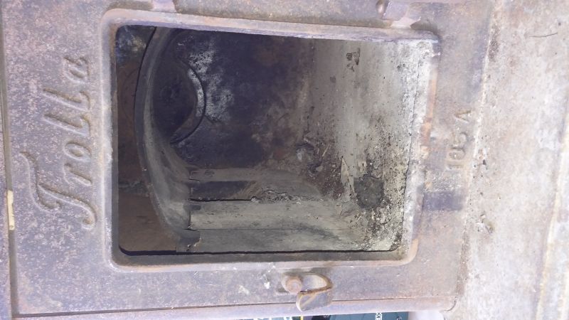

 Taiwan is cast into the back so it must be a knock off. Inside brick needs redone. Seller said they've never had a fire in it. Found a local shop that will blast and coat the outside for $150. Do you think it's till a good deal?

 Quoting: Solitude WA Taiwan is cast into the back so it must be a knock off.If it is a knock off do not buy it!!! They made those cheaply and cast iron is very easy to crack. It is funny how similar the knock offs are, they almost look the same but are cheap crap. Go with the Morso they are very good stoves and compete with Jotul's or if you don't have any time left check JoeandZachSurvival channel on youtube, he has a tent stove in his tent/cabin. Maybe you'll like the setup.

 Quoting: xtolekbananx If it is a knock off do not buy it!!! They made those cheaply and cast iron is very easy to crack. It is funny how similar the knock offs are, they almost look the same but are cheap crap.
 Well Crap!! My dad went over to look at it today and said it looked pretty sound so I told him to go ahead and grab it. I was going to have him drop it off tomorrow for blasting.
 Are they bad enough that I should just cut my losses and try to unload it before I waste any more money?
 I'm thinking maybe I could get it blasted, paint it myself and give it a try just to see if the size/style works for my cabin. I hate to miss the deal on that Morso though too. I feel bad because I'm in Texas working and I don't want my family dealing with CL people and hauling cast iron all over town for me. I'm heading to the cabin for a week when I get home so I'm trying to get things in place to do the install while I'm there.

 Quoting: Solitude WA Well Crap!! My dad went over to look at it today and said it looked pretty sound so I told him to go ahead and grab it.

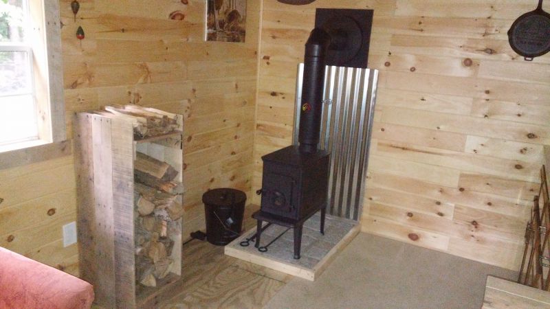

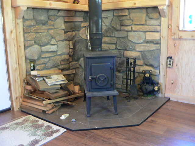

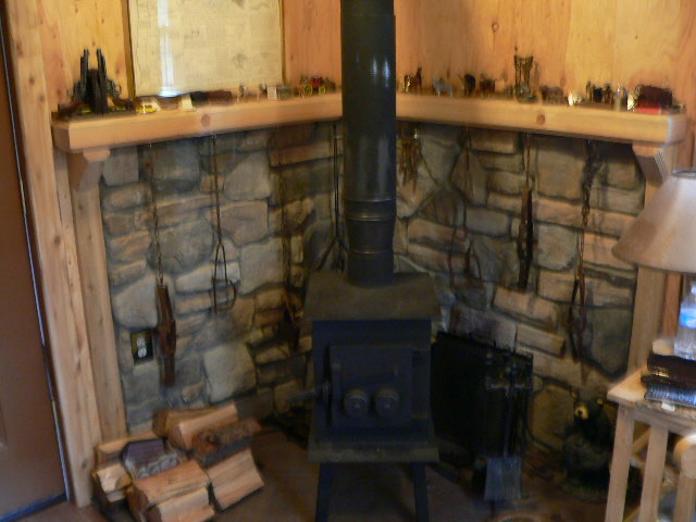

 If you already have it then go with it. Dont sandblast it. Take the screws and wirebrush all parts by hand paint itwith black stove paint and putit together. The bolts probably will brake so buy yourself some from HD or Lowes, just remember to get the GRADE 8 bolts, thay are strong and will not melt. Than seal all connections between cast iron parts with stove cement, this will ensure the stove will be air tight. Lastly lay firebrick using stove cement. Where the collar is put firerope and get y inch adapter, Its the same as for Jotul 602 adapter.
 And you should be good to go. Its not European but it'll work.

 I understand that new wood stoves are efficient and EPA approved but it is a hunting cabin not primary residence. I would like to have brand new stove too but here almost everybody is on a budget and we have to make things work. It makes no sense to install a few thousand stove in a hunting cabin either. A few weekends in the winter time you can make things work with old cast iron stove.
 I just looke at the prices of Woodstock stoves, all I can say is OMG. Some cost more than my cabin.

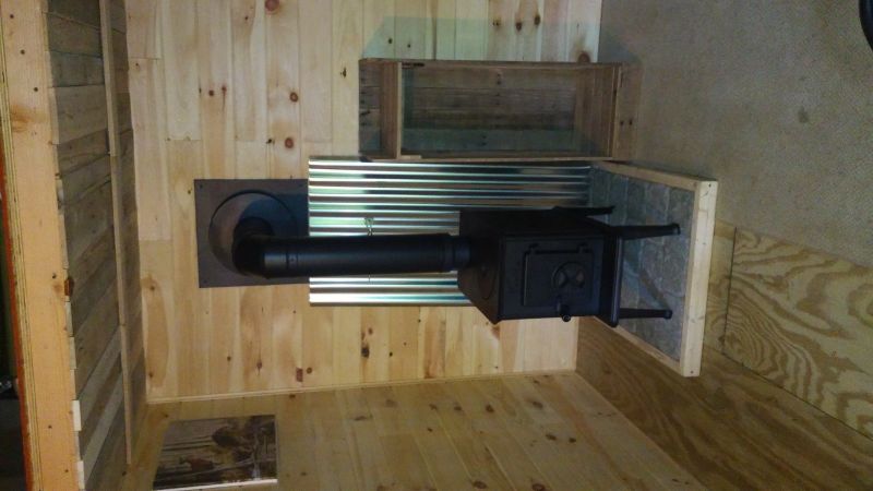

 This is how mine looked and above picture show how it looks now. I get 5-6 hours out of it and than it stays hot for a few hours after that. I cost me $150 and took me one weekend to restore it.

 Quoting: xtolekbananx This is how mine looked and above picture show how it looks now
 I had that same one under a different name, was called a Fjord. Was full of cracks, its the one I replaced. It had too many seams, burnt too fast and hot. Nice looking unit.

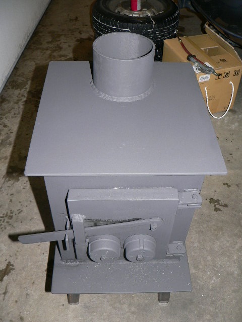

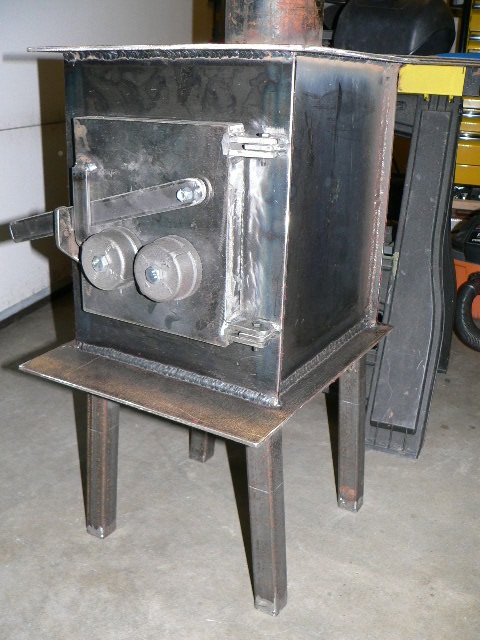

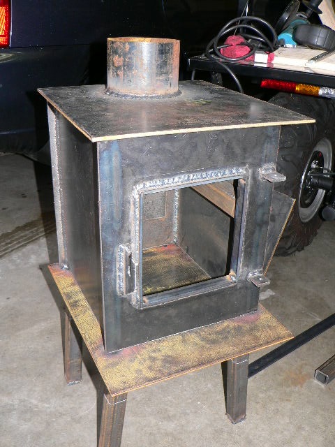

 I replaced my Fjord, exact same unit as the Trolla, I mean 100% identical. Made pieces, lots of small leaks, burn nice and hot, and I just ended up making my own. After removing the old one, was going to fill it with dirt and leave the round top cover off and plant flowers in it. A local neighbor swooped it up, so I gave it to him, he said it was full of cracks. One other reason I wasn't a fan of cast iron. So mine is all 1/4" plate steel, with full length welds, fully 100% water tight. Steel wont crack. Firebrick on bottom, both sides and back.
 Why did I build my own? I just couldn't find one the right dimensions I wanted, kept it shorter, so I have enough room in from of door to end of hearth, and made it taller vs longer. But its so air tight, I can smother it out. So one has to be cautious, you can get creosote build up. So I am mindful of that and I may be able to smother it with it being so air tight. A good pal that is a firefighter told me a great way to kill a chimney fire is to toss in a styrofoam cup full of water into the fire. It create a steam plume and it supposedly put the fire out.
 SolitudeWA, I have my place in north central WA at 3400 feet, we may be almost neighbors.
 Oh, that stove you got will run you out, but I see you do have enough windows. Its how I kept my place from getting too warm inside, heat the outside.
  |  Old Fjord stove (same as Trolla) now gone
 |  Building new stove 1
 |  Near completion...
 |  Finished stove

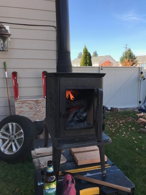

| Solitude WA Member
 | # Posted: 19 Dec 2017 11:25am Reply
 I got the stove all cleaned up, sealed and painted. The fire bricks needed replaced and they were a special size so I just went and got half splits and did a custom brick job. The baffle wouldn't fit between the larger bricks so I made it out of brick too. It seems to burn well as it is. I planned on installing later this week but we are getting dumped on with snow so it may need to wait until spring. I'm not packing that stove in through a couple feet of snow. I'll get some more pictures up once I get it in.
