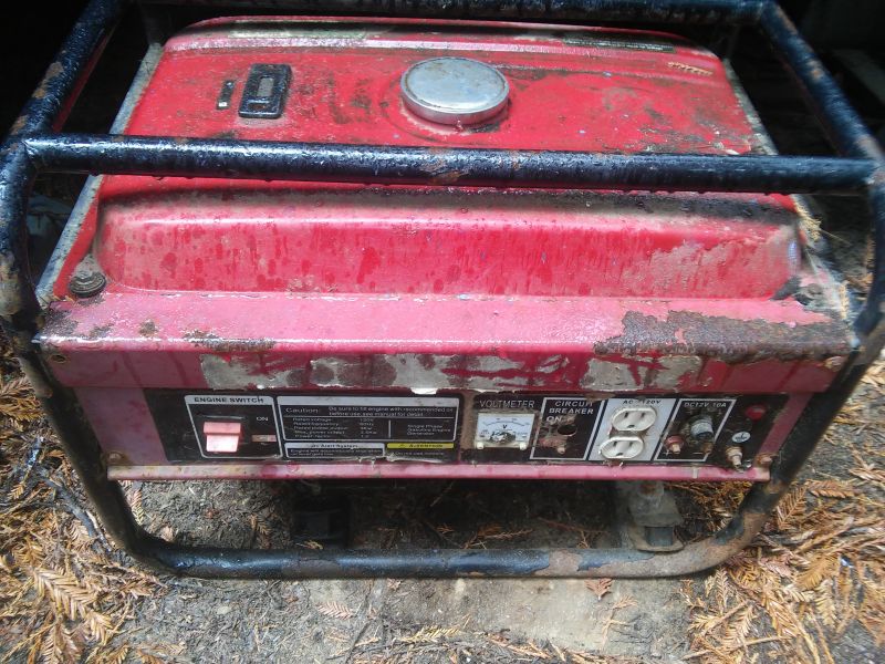

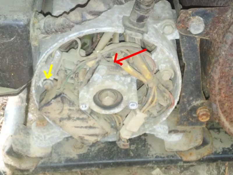

Today I took the cover off my crusty old generator (did I mention it's been under water, more than once). First thing I noticed, other than the filth, was the screw at the yellow arrow was gone, and the electrical gizmo it hold on was not held on by anything. The gizmo has a brass bushing in the plastic hole, maybe it's supposed to be grounded, so I took one of the cover screws and reattached it. I think the brushes are where the red arrow points, but I did not remove them. The slip rings looked fine.

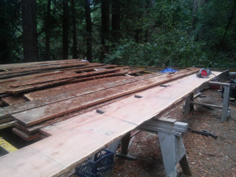

Anyway it ran better today, either that screw made a difference or it got over what was bothering it the other day. I ripped long boards all morning with the Skill saw and it purred like a kitten. I did notice when you first turn on the saw the generator does bog down and coughs for a second, then resumed it usual constant RPM. I also tired the compressor again, and this time it ran until 100psi when it turns off with no issues. So for now I think I'm good. Couldn't find a tachometer, my killawatt nor a model number on the generator. Maybe it is turning 3,700 rpm, it sounds about like other generators do.

well, if you threw it out today, you have gotten your moneys worth out of it years ago from the looks of it. So if its working fine now, well, puts you even further in the black.
# Posted: 20 Sep 2017 10:57pm
Congrats paulz on getting it going again. I have a similar one. It starts/runs fine. Doesn't need a tune up yet. But I did change the oil this year!

# Posted: 20 Sep 2017 11:24pm
Quoting: darz5150 But I did change the oil this year!
LOL, funny. That thing is rough looking.
# Posted: 21 Sep 2017 07:12am
Well the old saying that a Picture is worth a 1000 words... Paul, by looking at that, it has had a Rough Life (no doubt about that eh) AND been drowned a few times too ! Hell, it still runs ! Whatever you paid for it and the use you got from it over the years I would not complain too much and certainly would NOT blame it on the "Made in China" - it still runs given it hasn't been gently treated, that has to be worth some positive points.
