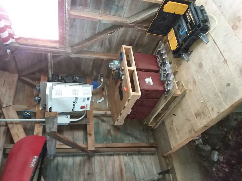

Basics: 9 Solarworld Sunmodule plus 260 poly on boat house. 8 Trojan 330 ah batteries. Had to hand dig 86' trench to bury cable in metal conduit...fun at 58 years old.
See if this picture works

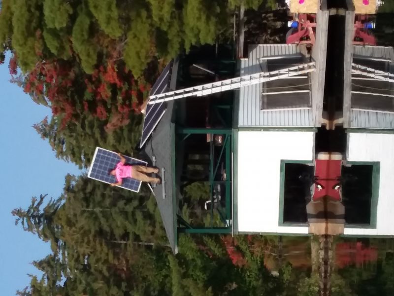

# Posted: 29 Sep 2017 05:00am
Boat house

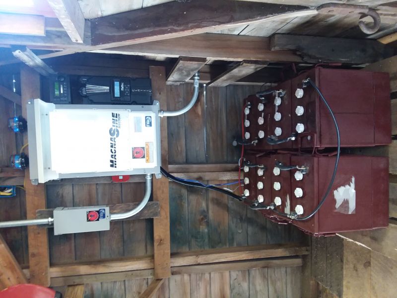

# Posted: 29 Sep 2017 05:03am
All in one unit.

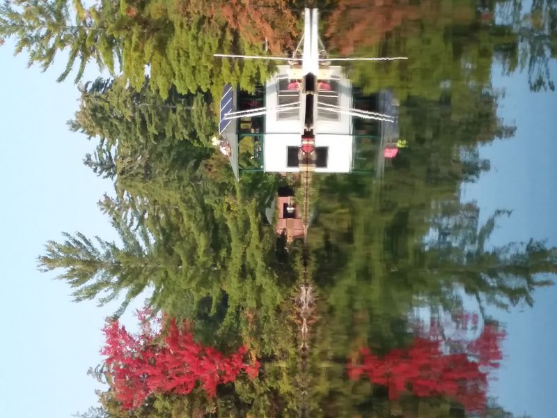

# Posted: 29 Sep 2017 05:07am
Pretty sight.
Nice trees too

The reason I don't leave them is I am not convinced that the panels will shed snow. See pic above. If you think I'm wrong and they will shed, I won't make the same mistake next year and leave all in place.
There was light snow on the panels in the morning, 7+/-, that did melt off so maybe I am overreacting.
I also assumed that they needed tending, (add water periodically).
As for lithium, I was under the impression that they could handle cold weather. It hit 30 below F a number of times up there last winter. So would this preclude lithium?? Then again, it would sure be a lot lighter.
Thoughts on my panel angle/fear of snow shedding??

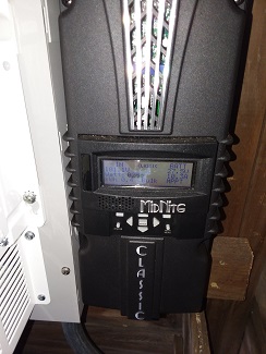

rachelsdad
# Posted: 21 Nov 2017 07:51am
not sure if you can read the charge controller figures but it has
IN: 101 V, 284 Watts .04 kw
Battery: 27.5v, 10.3 amps.
This was late morning

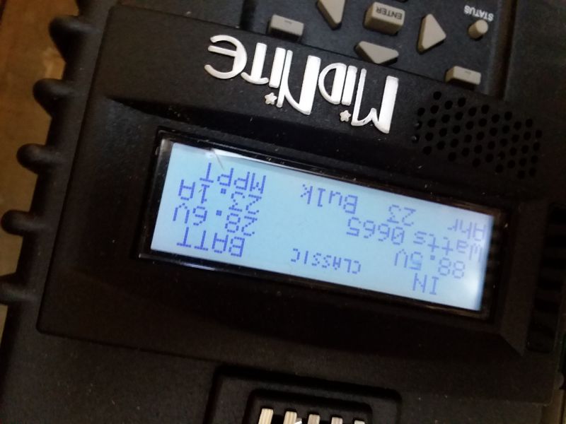

rachelsdad
# Posted: 21 Nov 2017 07:56am
Can't post the charge controller figures but it has

Quoting: rachelsdad The reason I don't leave them is I am not convinced that the panels will shed snow. See pic above. If you think I'm wrong and they will shed, I won't make the same mistake next year and leave all in place.
I doubt those panels would shed snow until you have several days of above freezing weather.
If it were me, I'd just make sure they were fully charged, top of the water, and disconnect them so there is no draw at all on them. Then I'd plan to make one or two mid-winter trips to the place and top off the charge with a generator. Batteries don't self-discharge much in the cold. They also don't lose water just sitting there.
If a mid-winter trip is out of the question, I'd get a small panel and a cheap charge controller. Hang the panel vertically on the side of the boathouse and connect it to the controller and batteries. Disconnect the other system from the batteries. The small panel won't get buried by snow and only needs to produce enough juice to keep the charge controller on and the batteries topped off. The batteries would not lose enough water to matter over the course of the winter.

The panels will definitely not shed snow. I just got back from 4 days away. My panels were almost melted clear. Sunny above freezing today. But for 3 days they were covered and the batteries were extremely low. Luckily. With lithium. Who cares!

So NorthRick/Creeky, it's just the nature of the beast that panels don't shed, or is it my angle of install?
