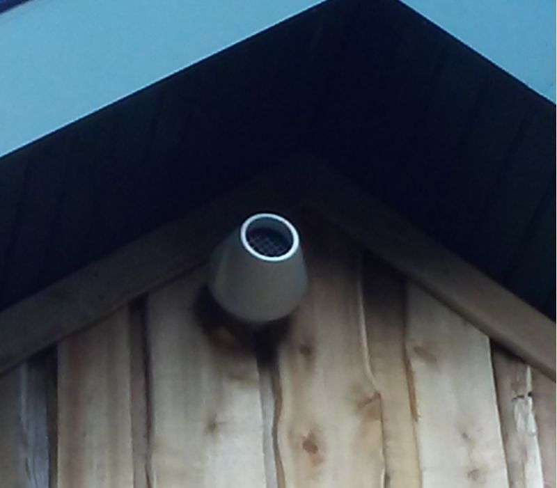

BTW a last note... a completely unintended bonus for me and worth consideration... My Pump/Power house is 70' from cabin, I have 2, 4" O-Pipes running 8' deep from cabin to pump house (1 water, 1 electric) air temp coming from the pipes into cabin is 11C/52F year round.... does make a difference and completely unintentional bonus. These are of course unperforated and the depth is there because when we excavated with the big machine I had the guy trench it for me... Anything 1' below frost level will give you roughly 50F/10C air temp... that's a gain in winter and cooling in summer... All Natural Heating / cooling, hook a 12V box fan (low speed) and bob's your uncle. Had I known, I would have used 6" O-Pipe ! Guess what the Greenhouse will get ? 2, 6", 100' loops....
IPEX system 636 Vent Cap
My HRV vent installed.
