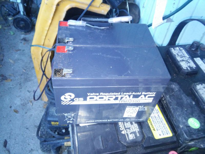

I haven't noticed 12v lithium car batteries in stores, are they available and if not, why?
Also, I have these two 12v 10ah scooter batteries I need to replace. $35 for the pair shipped for the same, anything in lithium I could use? It has a wall charger.
