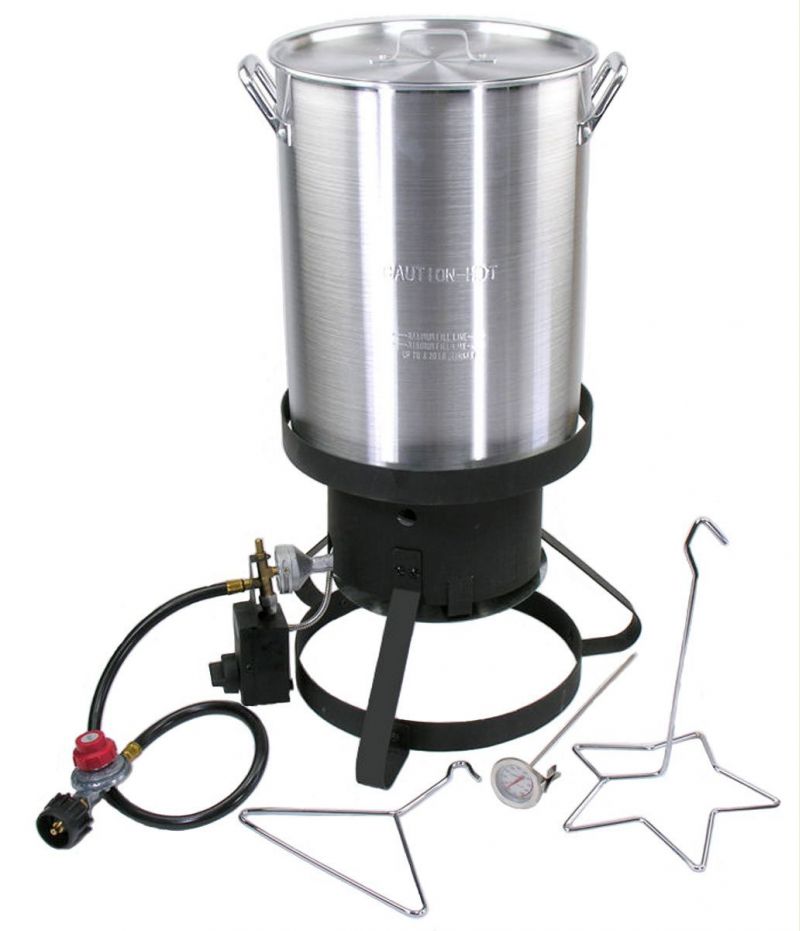

I was thinking about how I could fill a tub of hot water for my wife and my neighbour suggested simply buying a propane turkey cooker with the big pot. Fill it with water, boil it and empty into tub. these burners are 60 BTU - so it would go pretty fast. I though it was not a bad idea and pretty simple for our current situation. Anyone else have a better simple system they are using at the moment? Ideas welcome...operative word being "cheap" !
Turkey Fryer
Turkey Fryer

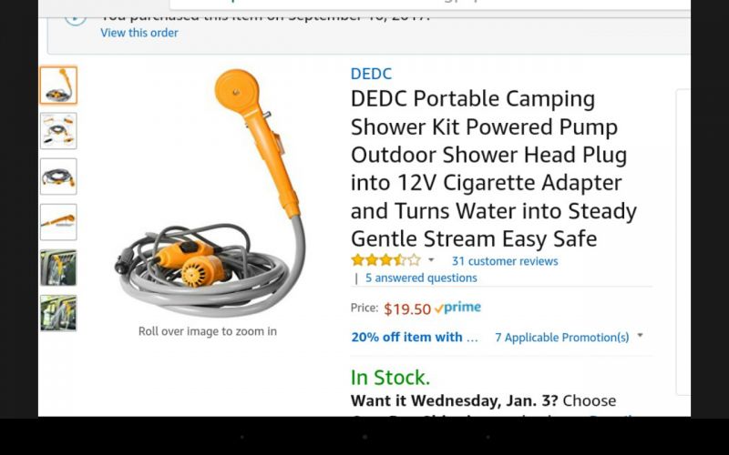

I got one of these for a buddy of mine. He uses the turkey burner or the stove to heat the water. He has a shower stall roughed in. He powers it with a portable jump box with a lighter plug built in. He and his girlfriend love it.
# Posted: 30 Dec 2017 06:34pm - Edited by: DaveBell
$120

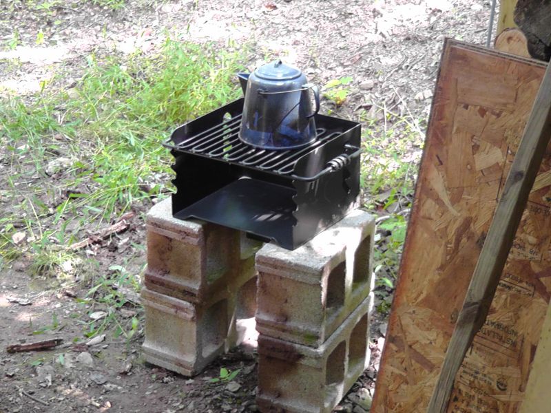

Free Fuel.

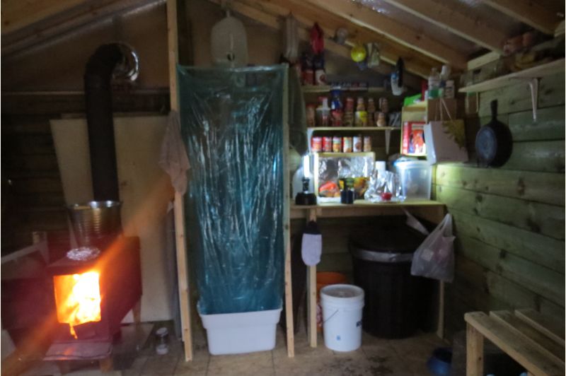

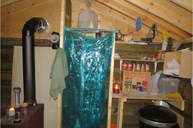

Takes a little effort, but I heat water on the wood stove, pour into a plastic caring tote with a shower head attached, and hang on a hook on the ceiling.
I have a shower curtain with a large plastic tub to stand in. Works great........
