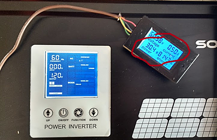

# Posted: 16 Jan 2018 08:40pm - Edited by: creeky
Not sure anyone is really interested.
But I just got my hands on the new W10 series inverter from Hefei Yo Power. I got a 3kw unit for testing. First impressions, its a beast. I'll have more testing later.
Right now. Its the first "hybrid" I've gotten ahold of. They don't have an MPPT solar controller yet, so I left that out. But the inverter and battery charger are complete with transfer switch. Pretty nice.
And at 30 kg not a light piece of kit. The complete opposite in fact to most of the new "DSP" inverters. Which are quite light.
So. Long story short. First test comes up with
* 30 watt idle load
on a 3kw pure sine inverter that's real good. when I felt the weight I was worried we'd be up in the 60s. But nope. Right in line with "todays" pure sine inverters.
Battery Charger is load settable. C1 to C6. So at 48v that's 250 to 1500 watts. Give or take. (5 to 30 amps)
This is ideal for folks with smaller generators. This way you can protect your generator from excessive load/gas guzzling/burn out. Hefei suggest sizing your genny at 3X the charge current. Which might be low depending on your home loads. Remember, when the genny is running its charging your batteries and running your home loads. So if you want to keep your genny running at 50% for longevity. Well you draw the line. But at least the capacity to adjust charge rate is there.
And like all new equipment that shows up on my test bed. I'm a bit enamoured now. The voltage tests out at 120v exact and 60 hz exact.
Can't wait to get it on the oscilloscope and then hit it with some load tests.

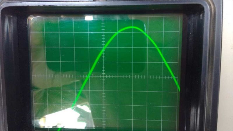

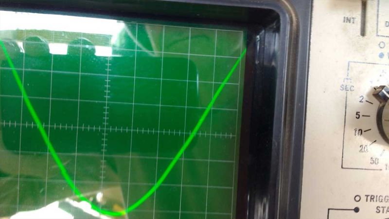

I don't know a lot about the W10. Uses 5th generation chip.
But the wave form tests are in. Perfect sine wave. Huzzah.
I also tested the charger at C2. Gets a good hum going. But it sure charged up the battery in a hurry. I didn't test the cut off point as I wasn't able to be there to monitor.
Now, with work and play obligations the testing will cease until March.
Still. i will be carrying them at bobolinksolar. and that says something? If anyone wants one. i'm trying to get them configured with MPPT controller. which would make them an "all in one." Inverter, charger, solar control.
I will also have them custom set to Lithium charge/discharge needs. Remember tho. These are lower cost than the big brands, so even with the two year warranty, lifespan is less certain. And the new Victrons are out with 5 year warranty. If 3x the price. And can be set via software to anything you might need in the future.
Btm of wave form
Btm of wave form
Top of wave form
Top of wave form
# Posted: 26 Jan 2018 03:05pm
And before you ask. Yes. I was too lazy to use the "probe". I just used alligator clips and the wave form is mighty big on the screen.
