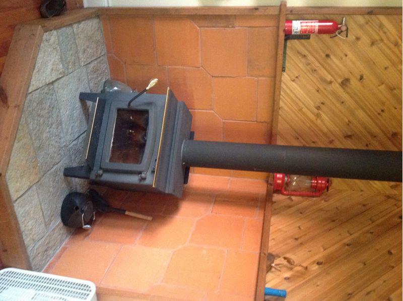

  Ok... I'm not even sure what it is made of sine we only had the cabin for a month in the fall and used it once, so I don't remember but duh I just remembered that I took a picture of it !
Kamn
# Posted: 17 Feb 2018 08:46am
  Nice little stove  Start your fire and stay warm. The body of that stove is heavy gauge sheet steel, probably cold rolled and not much you can do to damage it unless you run it over with a tank or load it with explosives

  Thanks for the advice!  Another stove question... I recall on this stove when I look inside (I wanted to look into the pipe) there is a horizontal plate that is below the chimney pipe that spans across the stove but not completely to the back.  I am curious about this...what is it and Is it removable?  How otherwise would you check up the pipe?
Greenland South
# Posted: 17 Feb 2018 09:41am
  That is a baffle plate. It may or may not be bolted in place. Many are welded in and are part of the the stove structure. Depending on the configuration you may have to remove the flue pipe after cleaning the chimney in order to clean off the top of the baffle plate. Keep in mind the Fire Code in Canada states that chimneys must be cleaned and inspected yearly.

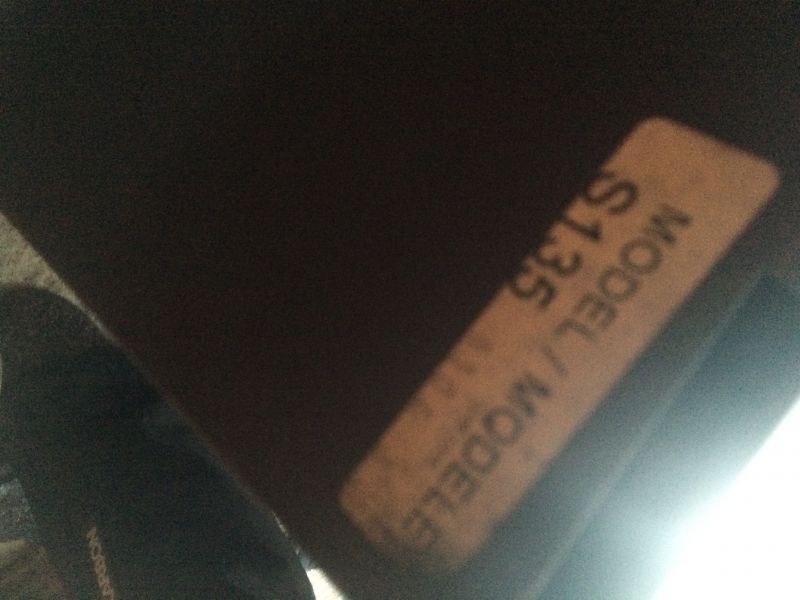

  Have a look on the back of the stove, you should see a certification label. The make and model will be listed on it. From there you can go on line and download the user manual (I'm assuming you don't have it). There is good info in that document that you need to know about your stove.

  I'd wager, knowing where Rick is, that the stove pictured is most likely a  Drolet /  SBI product.  Label on the back will give the make & model and all their manuals are available online.  SBI owns many brand labels btw.

  It might be a haugh’s or century s135.  I checked it quickly and thought W Hersey was the brand but didn’t know that they were the certifying body. I didn’t get a great look and didn’t have my phone to take a pic
  Cfm Corp?

  Quite possibly a Century Wood Stoves product (also owned by SBI) https://www.century-heating.com/en/products/stoves/   and they are marked with CWS or similar (TSC Sells many of them), CFM Corp was the previous owner I believe.   The model # should be on the silver sticker on the back If it hasn't been melted or scraped off.

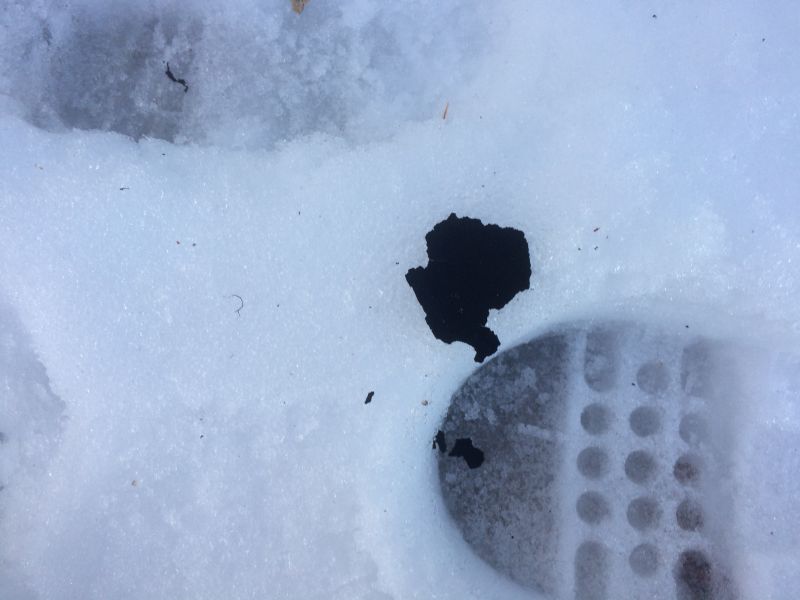

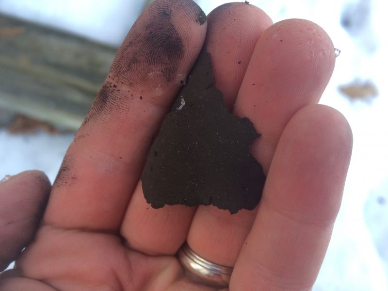

  Well, went back today with hopes of staying the night... I picked up a chimney thermometer, brought carbon monoxide and smoke detectors, got wood, had axe. It was 2c outside.  I started a fire and followed the standard approach.  2 hours later it was only 6C in the cabin.  My wife found little sheets of black stuff on the ground.  I'm assuming some buildup either in the chimney or cap. Needless to say between the blacks stuff and temp we came home.

  The black chunk is creosote build up inside of the chimney or possibly corrosion from condensation in the chimney. Did you clean your chimney and stove before you started a fire? It's best if you clean everything in the spring after your done burning, although most of the time I clean mine in the fall before the heating season. You will usually end up with more corrosion waiting until fall for cleaning. Do you know if you have single or double wall pipe? I'm thinking it would be double wall. Many times when you burn a fire hot in cold weather it will draw draft hard enough to pull out the creosote out of the chimney and will land on the roof and surrounding areas. As far as heating up the cabin, did you close down the draft on the stove so the heat was not going all up the chimney? Once you have a good burning fire this needs to be done in order to radiate the heat into the cabin. Be safe and good luck.

  Your inside pipe most certainly appears to be standard single wall pipe.  Damper should be installed at 16" from top of stove, there isn't one. (Ont. Code).  It can take a couple of hours to heat the bones of a building up once frozen solid, till then, you are fighting the cold thermal mass of the building.
  A small Strove Fan on top would help shift the heat from going straight up into the room, they are on sale presently @ Home Hardware for the better ones, roughly 1/2 price.  That stove is setup to have a blower on it's back, a blower kit would heat up the room space much faster, they are usually 120V and a fairly standard one is typically around $120 +  pending if it's special / unique (not usually, fairly universal) and easy to install, 3, 4 screws.  IF that stove is RV Approved then it may also have provision for external air intake for makeup air, those are not usually installed in a regular building unless they are very air tight (like my build) or if you are using other oxygen consuming appliances (propane/gas appliances or other).
  Guess you didn't get the label, make & model # off it.
  Suggestion, when you go to install a damper, it would be a good time to split that long run pipe so you can dismantle it for cleaning, the "adjustable" black stove pipes are good for that.   There isn't a Damper which is quite a surprising, obviously not installed by a certified WETT installer.  Insurance may (and likely will) require  a WETT Certification for it prior to insuring the property.  Damper is about $7.00 for an iron one to fit a 6" pipe, Adjustable pipe is around $25 if memory serves.
  I recall from a previous post (I think it was you anyways), you had said that the chimney goes straight up through the roof, that will add to your cleaning fun, as it means covering up inside and under when dismantling the pipe.  NOTE, You can buy a Chimney cleaning / brush kit from Home Hardware as well pretty cheap too and that will have the extensions to go all the way up, messy job, so have a good Shop Vac with a fine filter on it.

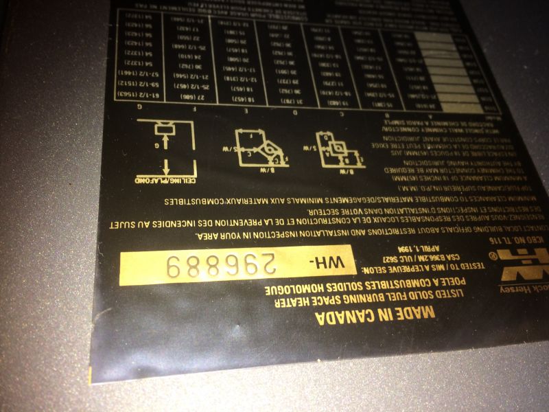

  Thanks will check into the damper.  I will get one if I have to have one but I was under the impression that the air adjustment on the stove was sufficient? The stove is definitely wett certified.  73C371EB38B940729.jpeg
