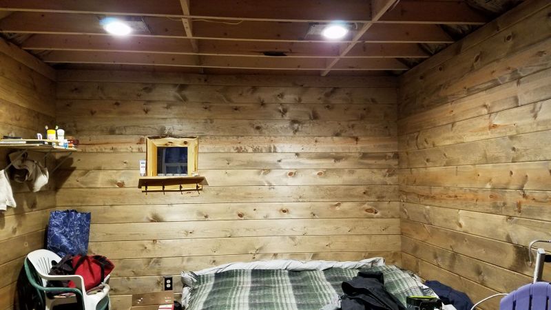

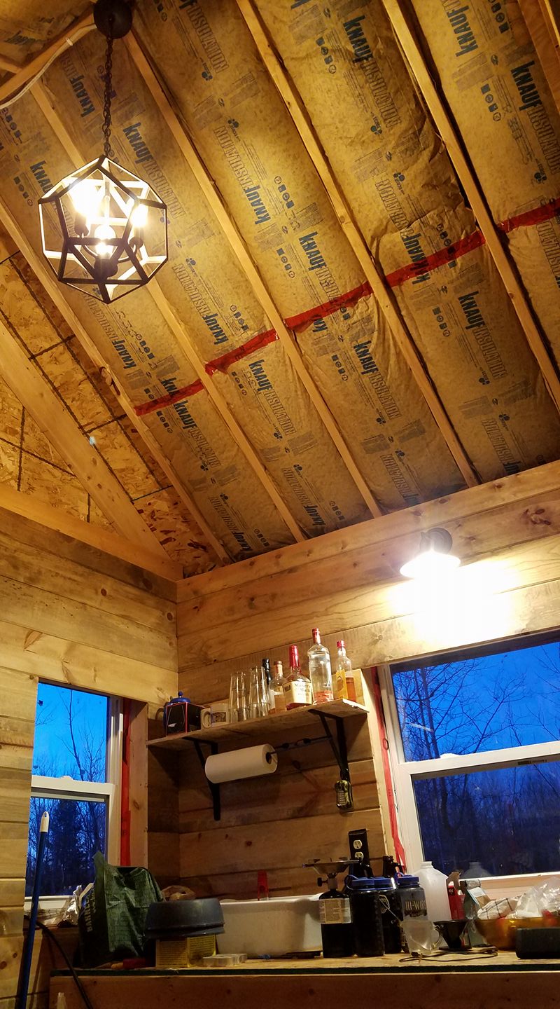

  Got most of the wiring done a week ago, minus the inverter (due to a shipping snafu, now I wish I HAD ordered the 1200. oh well) and distribution panel. We will be headed up again soon to finish the wiring, but having lights was awesome.
