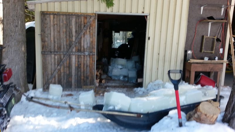

u could put up some ice
neckless
# Posted: 20 Mar 2018 12:02am
put up ice
neckless
# Posted: 20 Mar 2018 12:03am
i have a hard time to post pics
