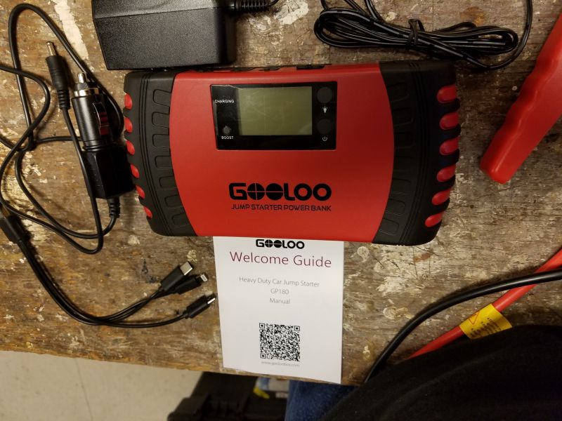

I bought this last fall on a whim and because it was on a deal.
Charged it up and put it away for about 4 months.
Today I checked and the display reads 100% charged.
So far, so good.
Here's the question. My daughter in law frequently goes to camp by herself and that deep cycle marine battery to power the water pump is heavy for her to lift and maneuver. The pump it is intended to power is a Shurflo RV 12v/2.9 gpm.
Would I kill this unit by using it for this purpose?
Gooloo power bank
Gooloo power bank
# Posted: 9 Apr 2018 04:37pm
My surflow says it draws 7amps @. 2.7gal someone else will have to do the math..
cspot
# Posted: 9 Apr 2018 04:55pm
I am sure if you aren't using the pump very much that it would work. Not sure how those things are about constant use/battery drain.
What about hooking up a small solar setup to the marine battery so that it could stay in place?
beachman
# Posted: 9 Apr 2018 05:45pm
Usually those boosters are for high cranking amps as opposed to deep long operating. I don't think this will last too long. You won't know until you try it. I doubt if it will cook the unit. It will likely just drain it quickly. You might consider lithium battery that the DIL can carry to the camp to run the pump. They are pretty light weight and could last for several months.
