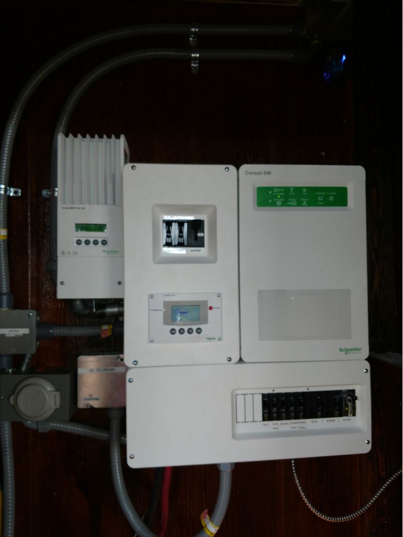

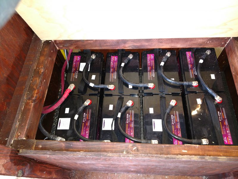

I have (8) x 6volt AGM sealed batteries. All other equipment is Schneider, MPPT controller, AC Box, DC Box and Inverter.... This is why I'm asking, the online consultant that did a wonderful job of getting the equipment and guiding me through install, says I need to go out no more than 6 weeks apart, turn it on and let the batteries charge for 3 hours, then turn everything off. This is my first season with solar and I love the system, just want to ask around to make sure I'm doing everything possible to protect it....![IMG_20180210_0751124.jpg IMG_20180210_0751124.jpg](https://www.small-cabin.com/forum/shared_files/uploaded/8213/116508_1.jpg) IMG_20180210_0751124.jpg

Might be worth going back to him and asking him "why". That might make it easier for other to provide more feedback/opinions.
# Posted: 10 Apr 2018 16:58
Quoting: razmichael Might be worth going back to him and asking him "why".
The answer was that electronics are safer from lightning if they're off..... True I suppose.....not much lightning out in the desert....

The AGM batteries can handle the no charging with the array or CC turned off for quite long.
