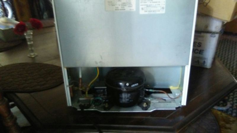

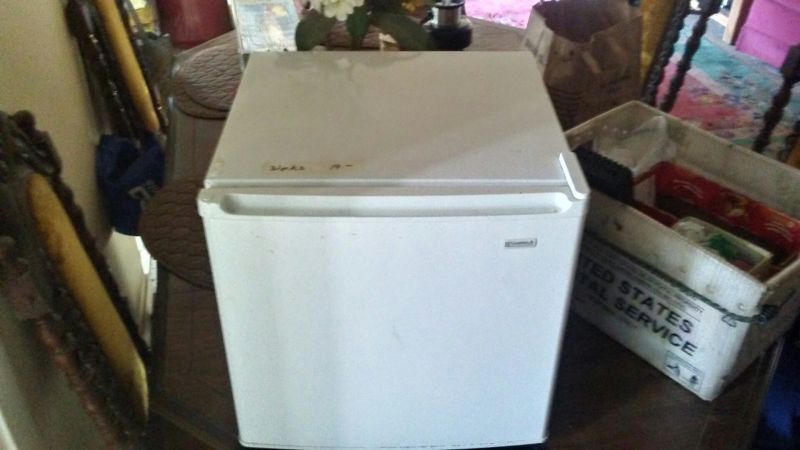

# Posted: 3 Aug 2019 12:38pm - Edited by: paulz
Another revisit. Bought this at the local rummage sale yesterday for, as you can see, $19. Testing at home with Killawatt. 350 or so at startup, 60 after that. 40 degrees inside, frozen cup of water in the freezer section. Cooled very quickly. 70-80 in the house.
Not sure what the plan is but I could sure use a cold drink at the cabin. I was thinking I might keep it in the truck bed, plugged in a home, then for the two or three days at the cabin try to keep it cold with a generator. Or just keep it at the cabin and run the generator a few time a day. I have small solar for DC but no inverter.
It doesn't seem very insulated, anyone had one apart? Could I spray foam inside the walls or something? Or rigid foam on outside?

Sounds good, I have a sheet of that foil insulation sitting around. Did you do the whole back side? The bottom half of the back on mine is open exposing the working parts. Guessing that's where the heat escapes.
# Posted: 3 Aug 2019 05:46pm
I did mine all over except for the cutout where the compressor is located. Wherever yours dumps the heat should be left clear. Mine uses a small fan for moving air over the coils.

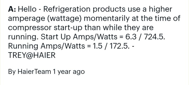

My answer was staring me in the face long before I posted my first findings. The information tag on the back of the fridge indicated a 6.x amp pull at startup. 6.x times 120 is over 720 watts.
My 500w inverter has never failed to start the fridge but it does get the fan going for a second or so.

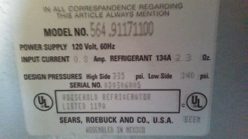

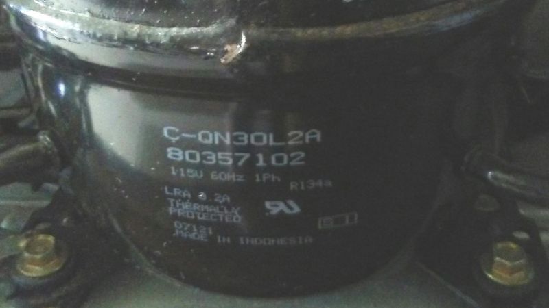

# Posted: 4 Aug 2019 05:08pm - Edited by: paulz
Back of mine. Says .8A at 115V
That black pot is too hot to hold a hand on. Don't see any fan.

My fridge started on the chart on the back of the fridge thr startup amp draw of 6.x amps. (Cannot remember the exact figure)
https://homeguides.sfgate.com/check-amperage-refrigerator-44156.html

# Posted: 5 Aug 2019 06:57pm
Wilbour,
Good catch, checked mine also says 6.3 amps, explains a lot, even with soft start that's a good punch.
