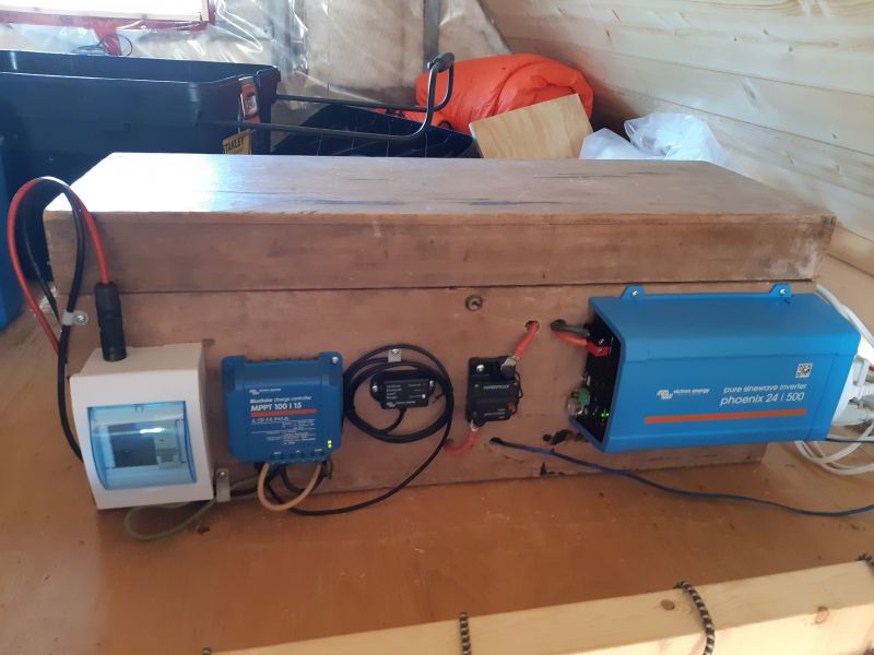

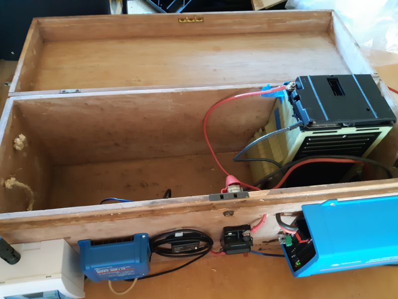

Update. I'm making room for another 1kw of lithium storage. I have no problem making electricity but on really warm summer days I can get a little low on power.
My original setup was intended to be portable but honestly I haven't moved it since I set it up. I now have all the shiny bits on the outside of an old wooden tool chest (thanks grampa). All the nasty bits like bus bars and the batteries are on the inside.
Now I can see what I'm touching when I turn stuff back one upon a arrival.

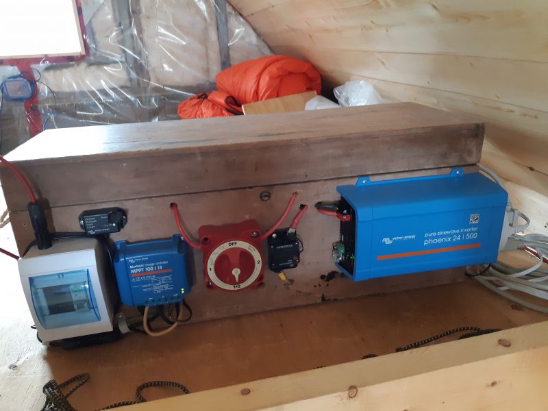

Anyways, I asked a good friend of mine to score me an additional 1kw 24v lithium battery. He did just that and cut and crimped the cables with the exact terminals I needed.
Next I picked up a battery cutoff switch from Amazon that allows you to choose battery A or B or both.
This is helpful as I can remove each bank as required. The whole system is in my loft and I cannot carry the system up the ladder so I move it without the batteries. The switch gives me the piece of mind while assembly the system when needed.
