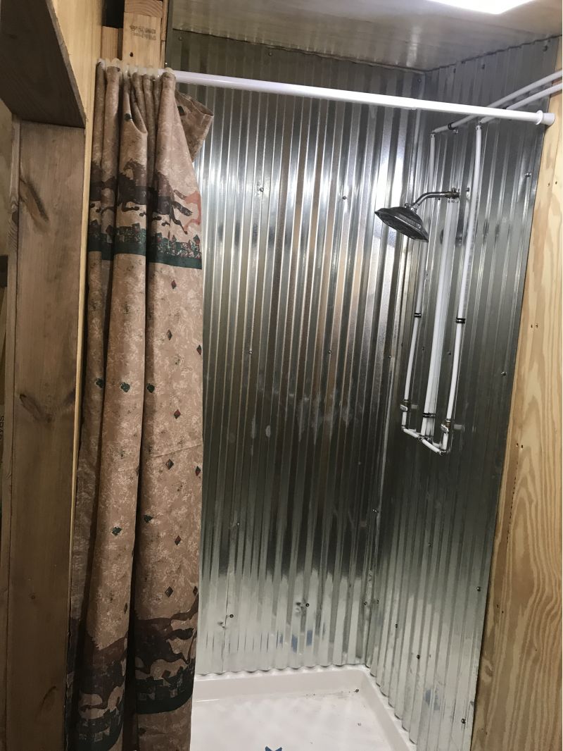

OK so finally got some temp water hooked up at my shack and tested out my shower set up. I'm using an Eccotemp L10. In my shower I have one ball valve for the hot water and one ball valve for the cold. Granted ball valves are not good at regulating water flow so may have to change them out. We have great water pressure, 40 psi, from the well at the cattle tanks. Seems when you try and regulate the water temp you end up shutting down flow through the heater and then have to shut everything off and turn it back on to get hot water again, then it gets to hot start adding cold. Can't get maintain a constant comfortable temp. Was thinking about getting a real shower mixing valve or changing to a gate valve instead of the ball valves.
Thoughts, suggestions, ideas or how do you guys regulate yours?

So as i was driving out to the lease, 4 1/2 hours of time to think, I had another thought. Shower heads these day have restriction in them. So when i got camp opened up i took the shower head off and started to pick and dig at the restriction plate. Got it dug out. Adjusted the heater to the lowest burner setting and turned the water flow to max on the unit. Tried it with just hot water only and it was still to hot for me so opened the cold water valve in the shower slowly and amazing i was able to adjust the temp now. Granted the ball valves are extremely touchy, granted ball valves are not designed to regulate later i will change them out with a better style, maybe a good needle valve.
But long story short it works & lots of lessons learned.
