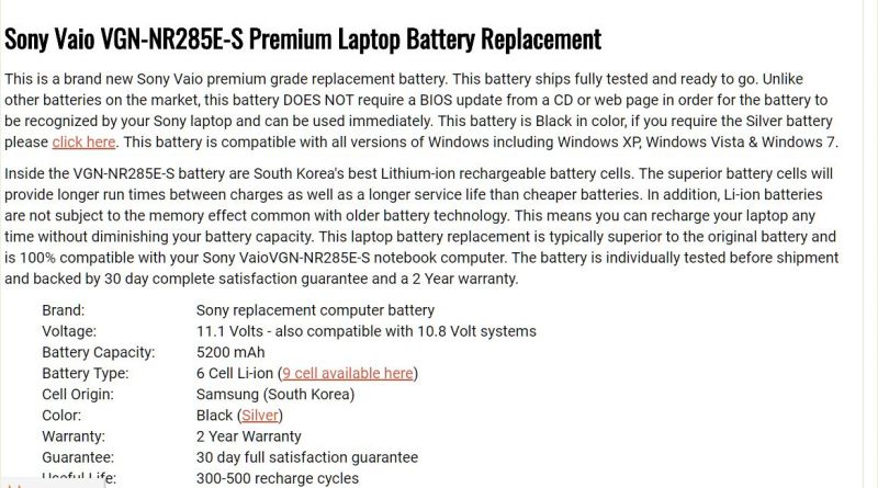

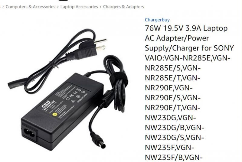

Here is the replacement battery for my laptop, 11.1v, and the power supply, 19v. I cut the wire at the output side of the power supply (and test for polarity and voltage, it was 19 something, then jumpered to a fully charged car battery. Wouldn't boot up. The laptop battery has about a half dozen terminals, no idea how one would jumper there. There must be some circuitry inside, maybe I'll crack it open.

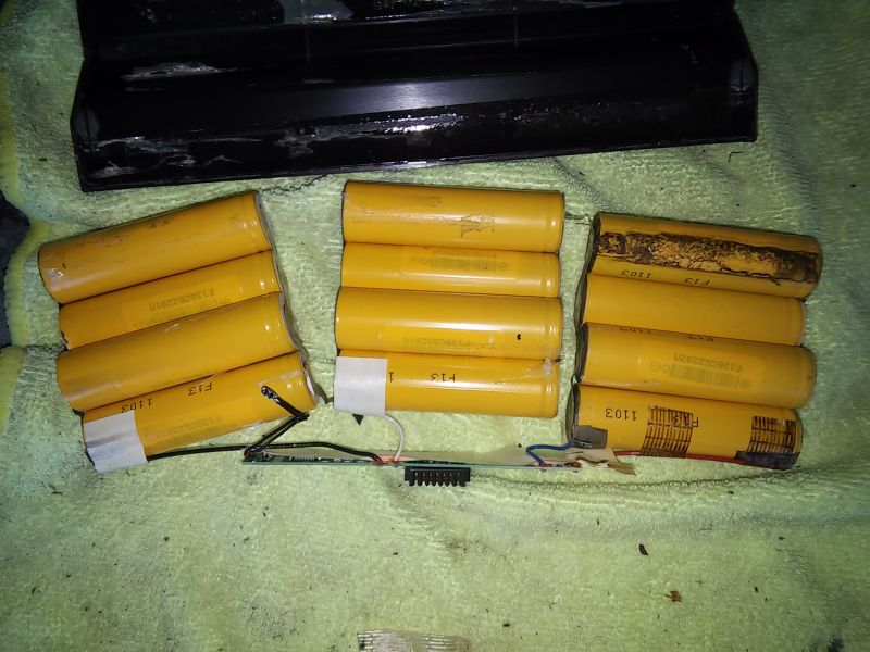

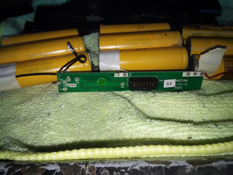

So I gather from the above link that it will run on 11 (or hopefully 12) volts if I can replace the battery with jumpers. I opened up the old battery, sure enough there is a circuit board and several wires running to it. The one black on in the photo was just taped to the side of one battery, a thermal thing? Not sure about the blue wire on the other battery. Harrumph, never easy..
