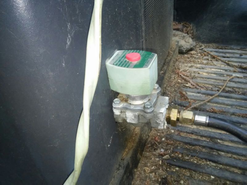

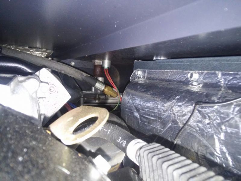

Me again. Need to fill my water tank, I haven't used the 220v propane fueled Briggs generator since last year. Got spark but no start. I disconnected the propane hose at the carb, nothing coming out. It has this one thing, a regulator I guess, on the outside and another big round thing inside with the hose going to the carb. Gasoline engines I understand blindfolded, not this. Do these things need to be cleaned out, could they be stuck? Can I spray something in there? 0620181312_resized.j.jpg

# Posted: 20 Jun 2018 11:43pm
Reply Quote
That item in the first picture is an asco safety shutoff valve. I has to be powered from somewhere to open. Trace the wires back from it. Probably find a switch of some sort. Electric start generator I presume? Is the battery dead and are you trying to pull start it? Probably needs battery power to start.
# Posted: 21 Jun 2018 04:22am
Reply Quote
Thank you guys. I have a 20lb. tank plumbed into that asco valve and when unhooked from it plenty of gas comes out the line. It must be that valve, and those red wires coming from it are visible in the second photo. I don't know why it would not be working just from sitting though. Yes it's electric start, uses a car battery and spins like the dickens, even runs with a spray of starter fluid.

Direct. When I first got the genney I hooked it up through the regulator that was on the BBQ hose I used but it would only run for a couple seconds, like it was running out of fuel. I went direct and it ran fine last year. BTW I had it sitting with the hose off and some tape over the fitting, the tape was loose when I looked at it yesterday, I suppose some spiders could have gone up in there. That part inside in the second photo must be a regulator?
