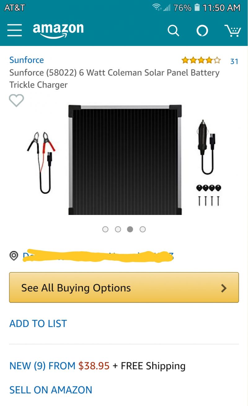

  I'm considering buying one of these to maintain my deep cycle battery used to power the demand pump at camp rather than carting it home each time to put onto a charger/maintainer. This is representative of the models I'm looking at. Does anyone use something like this? Experiences? Recommendations? Thank you.

  This is a trickle charger - at 6 watts (and that is the max) it will have a hard time recharging (hence it does not come with a charge controller).  Really, you need to do some analysis - capacity of battery, how much you use it during a stay and how long it has to recharge between stays - thus, given the amount of sun you expect, you might have a better idea of panel size needed.  I recently picked up two sets of 45w panels (two charge controllers) for about $80cnd each on sale.  Did some wiring to allow both or one to be used to recharge the kids deep cycle trolling motor battery.  They tend to use the trolling motor in large spurts but lots of time in-between.  You likely are better to look for something with a little more output and a small charge controller.

 Quoting: razmichael This is a trickle charger - at 6 watts (and that is the max) it will have a hard time recharging (hence it does not come with a charge controller). Really, you need to do some analysis - capacity of battery, how much you use it during a stay and how long it has to recharge between stays - thus, given the amount of sun you expect, you might have a better idea of panel size needed. I recently picked up two sets of 45w panels (two charge controllers) for about $80cnd each on sale. Did some wiring to allow both or one to be used to recharge the kids deep cycle trolling motor battery. They tend to use the trolling motor in large spurts but lots of time in-between. You likely are better to look for something with a little more output and a small charge controller.
  Thanks for this input. Actually, not wanting to get too technical in my OP I left out information that in hindsight I probably shouldn't have.
  The battery is rated at 140 amps reserve capacity. We keep it on a Schumacher SEM-1652A charger/maintainer while at home that puts out 1.5 amps.
  Our camp stays can be up to 2 weeks separated by weeks in between visits. When we return home (as we just did) the battery takes about 2 days to regain the green light charge. This is our typical usage and recharge cycle.
  I realize that I should buy a more powerful unit, but that photo was readily available and it served as an example.
