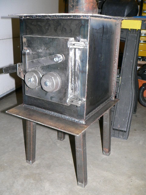

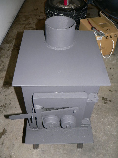

# Posted: 3 Jul 2018 08:37pm
In my state, its Quadrafire, Avalon or Lopi's. In my home, I have a Quadrafire Millennium 3100 flat top.
In my cabin, I used a TMT built unit. 1/4" plate steel, all brick lined, holds head for many hours. woodstove15.jpg
