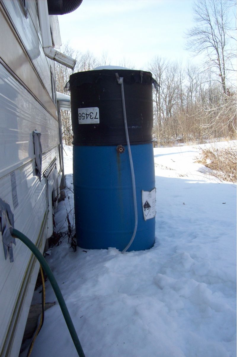

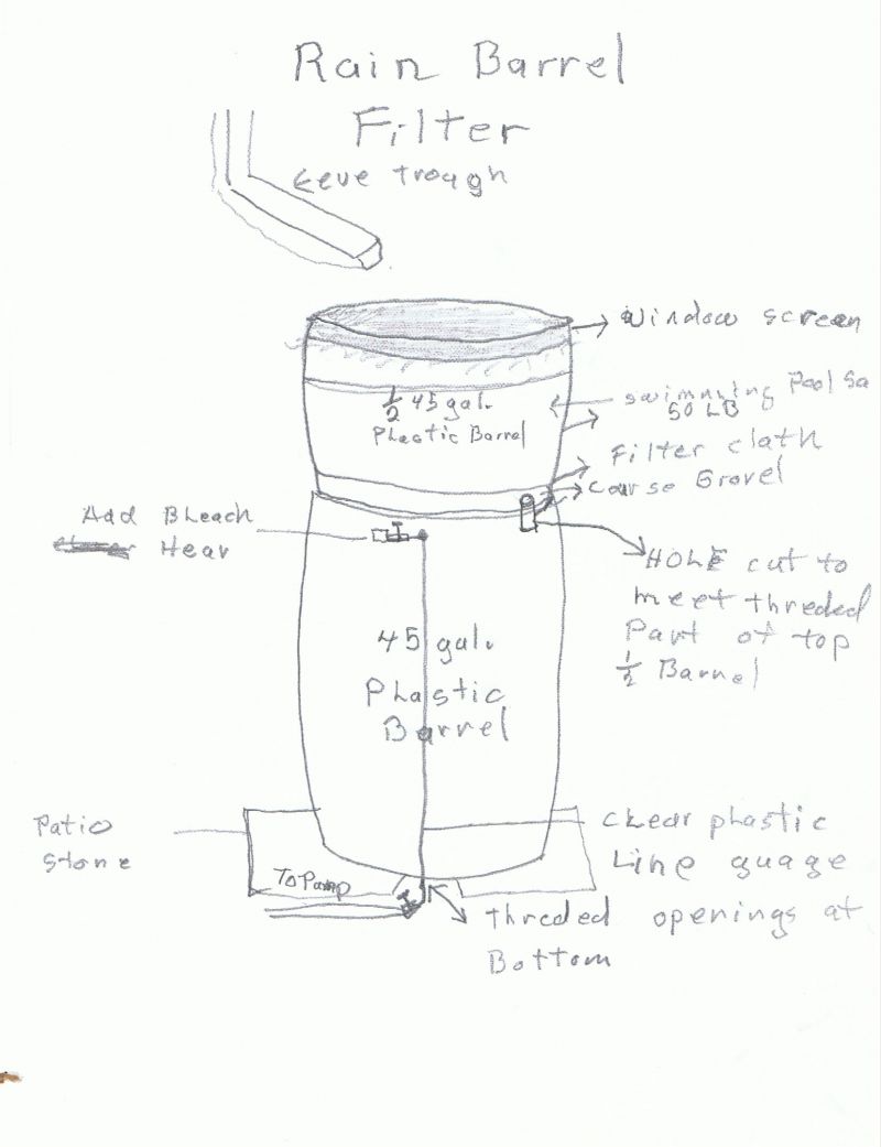

# Posted: 14 Feb 2011 09:34
Quoting: CAprepper
water
we have never ran out .. use it for every thing accept drinking even coffee and tea .sorry i have no pic i'll get you one first trip in the spring.. 2 ft. snow hear now !!!
# Posted: 14 Feb 2011 09:47
Quoting: Just
water
try again
sand filter
sand filter

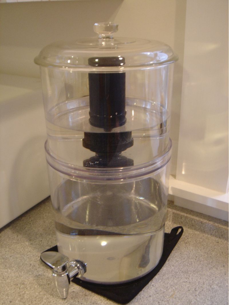

# Posted: 14 Feb 2011 23:08
I have used a Berkey lite for some time and it does remove the objectionable chemicals that are prevalent in the water systems around here due to farming. I ordered new filters this fall and wondered if I could figure a simple and inexpensive way to recycle them to make a small version for my moms house.
I searched for a ready made item to use for the containers. After a lot of searching at a local walmart I was about to give up when I spotted a clear plastic beverage cooler as they called it. It used a lower chamber for ice and had a spigot already in place on the lower part of the upper chamber. It also had a lid. I checked it out at the store and found that I could easily place the lid under the lower section and then it would sit on the top. Both pieces have a round mark right in the middle which made it easy to drill each one out with gradually increasing bits so as not to crack the plastic. I made it big enough to allow the plastic threaded part of the filter to pass though the two pieces. When you tighten the wing nut on the filter it holds the two parts together. I found a pyrex glass lid that was exactly the size of the containers to make a top for it.
I took the old filters and was able to pull the plastic caps off the lower end, some of the filter broke off in the cap, but with a small screw driver I was able to remove all the old filter and silicone that was holding it. Then I sawed the top portion to a length of 5" with a miter saw to make sure it was level. I purchased some food grade silicone on ebay in a small tube and glued the cap back in place.
One assembled it worked like a charm. The filters take most of the filtering at the lower part so when I installed the upper piece it acted like a new one and filtered quickly.
I think including the silicone I spent about 20.00 on the whole thing.
larryh
# Posted: 14 Feb 2011 23:12
Here is a photo of the above described low cost recycled water filter.
Berkey water filter recycling old filters in smaller container.

# Posted: 16 Feb 2011 15:56
spring thaw had a great walk in !! here is a pic of our rain barrel filter
we boil our drinking water
