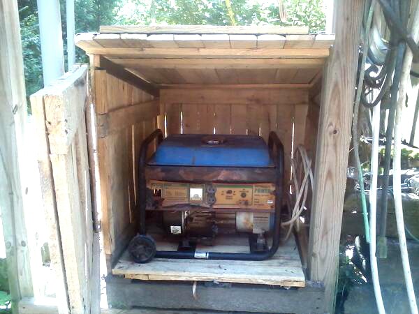

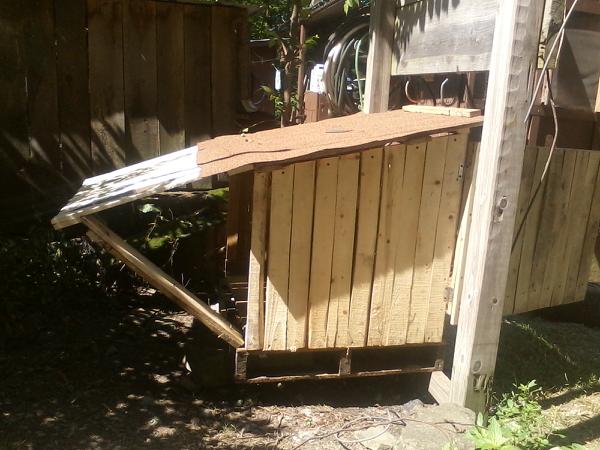

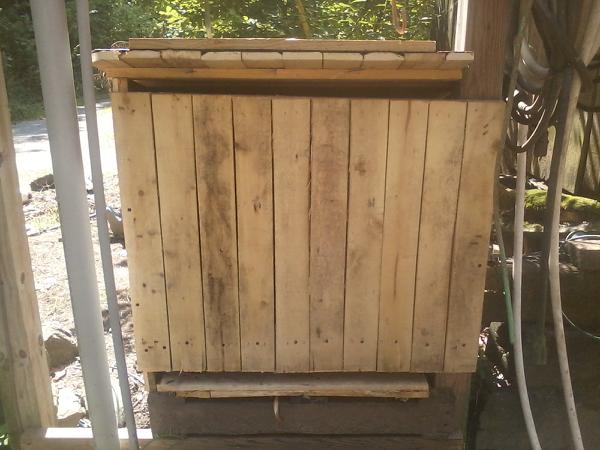

I built this dog house for my old jenny. Its about 10 feet from the cabin. Can't really hear it inside the cabin if we have a/c fans or TV/ radio on. Is the generator your only power source? Picture0724161126_2..jpg
