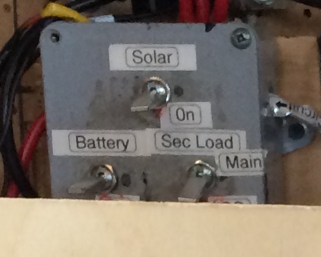

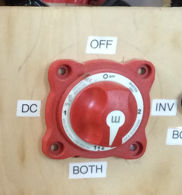

Just to add to cspot's info, I also use a marine three way switch. We turn it to "Both" when we arrive and "Off" when we leave so no worries about leaving anything running. I do run a security circuit off the CC load (couple of camera's, motion sensors and floods) which are left on. I also have a similar switch directly on the battery so I can isolate this as well.
Make sure you use a switch that can handle the max amps that the Inverter may use from the battery (this can be very high).
I also use a set of heavy duty toggles to allow for isolating the charge controller etc (for troubleshooting mostly). I too keep my panels out yearly to keep the batteries charged - important during our cold Canadian winters so the batteries down run down and freeze.
Wondering about your inverter drawing power when off - mine doesn't until I turn it on (I know some of the more advanced ones do "sleep" until needed but mine does not - we only turn it on when we need it as mostly we stay on 12V.
Switch
Switch
Toggles
Toggles
