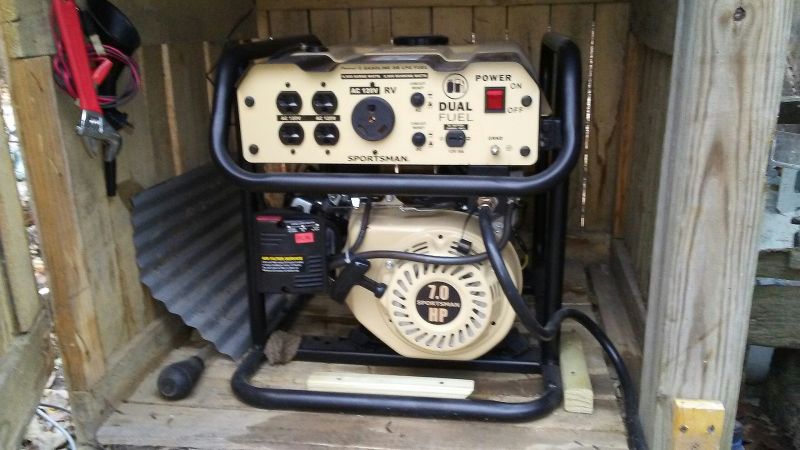

I recently got a dual fuel sandstorm 4000. Love it so far. Not as quiet as Honda probably. But I like the dual fuel option. It is a basic plain Jane but powered the whole cabin without any problem. 2 window ac units, chest freezer, fridge, lights and TVs. It has a pull starter but starts super easy. I contacted customer service to ask about parts availabity. I live outside St. Louis. And can get parts from them. In St.Louis. In fact I ordered another AVR (automatic voltage regulator) an extra set of brushes for it for less than $40. Just to have on hand. It comes with a one year warranty on it.

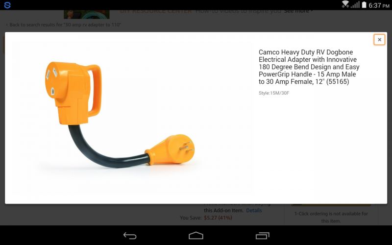

ICC - The 3000 has a 30A outlet that I have a cord wired into my electrical setup so i could power the cabin if needed....the 2200 only has 120A outlets...can I convert these?

Adaptor

Quoting: Borrego The 3000 has a 30A outlet that I have a cord wired into my electrical setup so i could power the cabin if needed....the 2200 only has 120A outlets...can I convert these?
As long as the power demand does not exceed the 20 amps a cheater cord as pictured above is fine.

Quoting: ICC As long as the power demand does not exceed the 20 amps a cheater cord as pictured above is fine.
Just lights and a refer...... YouTube has lots of videos on the conversion kits for the Honda, they will help... Thanks for all of the help guys!
