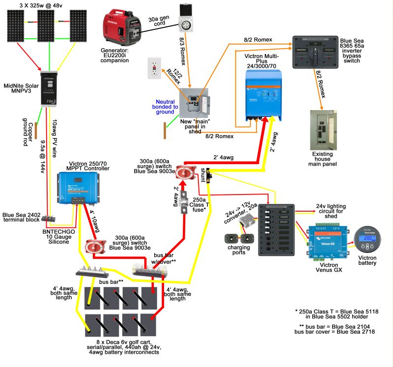

offgrididaho
# Posted: 9 Dec 2018 04:36pm
FWIW, here's my current schematic (after some helpful corrections from creeky, and with more changes I'm sure still to be made)
Schematic
Schematic

That is awesome awesome advice!! You laid it out like I haven’t read before and it explains sooo much. Thank you very much, sounds like it’s a no brainer to use some solar than. I really appreciate all the great advice from you guys.
