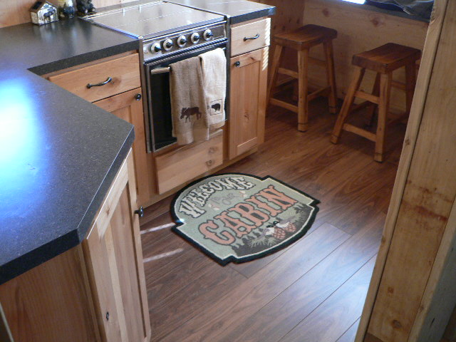

# Posted: 15 Dec 2018 12:51pm
Cooktop is from an RV, cabinet custom built for it (just basically added one under it as it doesn't go to the floor) and the counter was cut open for it, but notched, not cut all the way back. It is a perfect fit in a tiny cabin.
