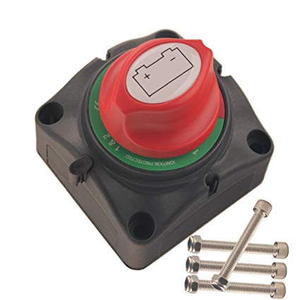

Might be easier to use an rv battery selector/combiner switch. Run your inverter on one side and 12 volt on the other side. During the day when charging, use the switch to connect the batteries together. Then before you go to bed, flip the switch to separate the batteries. Then you can hook your charge controller to either side. But........your charge controller works best when your positive side connects to one end of your battery chain. And the negative is connected on the other end of the chain with ALL the batteries in between.

Here's a switch from amazon. Less than $20 bucks. You can select battery A. Battery B. Both A and B. Or no batteries.

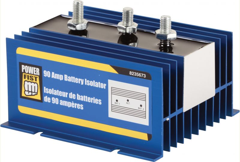

Well, a check-valve allows fluids to only go in one direction so the electrical/electronic version would be a diode.
kittysmitty
# Posted: 26 Dec 2018 06:12am - Edited by: kittysmitty
Reply Quote
Your looking for a battery isolator, which is just a big diode. Depending on how much charge current you have, amps, you could get away with something with a lower amp rating. https://www.princessauto.com/en/detail/90a-battery-isolator/A-p8235673e Here's one

A diode has a voltage drop of 0.7 volts across it. This is significant on a 12 volt system. A fully charged lead acid should read 12.7 several hours after charging while a 12 volt is discharged.

There are battery isolators that use FET's instead of diodes and have a very low voltage drop, but not quite zero. The isolated battery still may never reach 100% full as measured with a hydrometer but comes much closer than what happens with a diode system.
