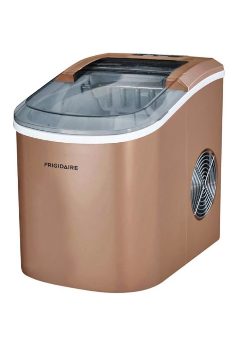

Went Christmas visiting a friend and they received one of these for Christmas.
Specs say 200 watts. I'm wondering if anyone has done any testing as to how much power is actually used. I would think similar to a fridge there would be a cycle, it would not draw 200 watts 24/7. Also, I understand that it would depend on how much ice is used.

OK, lets see if anyone agrees with my calculations.
11.8 kg in 24 hours, so approx .5 kg per hour.
Unit holds 1.2 kg, so it would run for 2.4 hours to fill
so to produce 1.2kg, 2.4 hours x 200 watts equals 480 watts.
now, once the ice is made and the unit is full, it would just run to maintain the ice.
Am I on the right track?

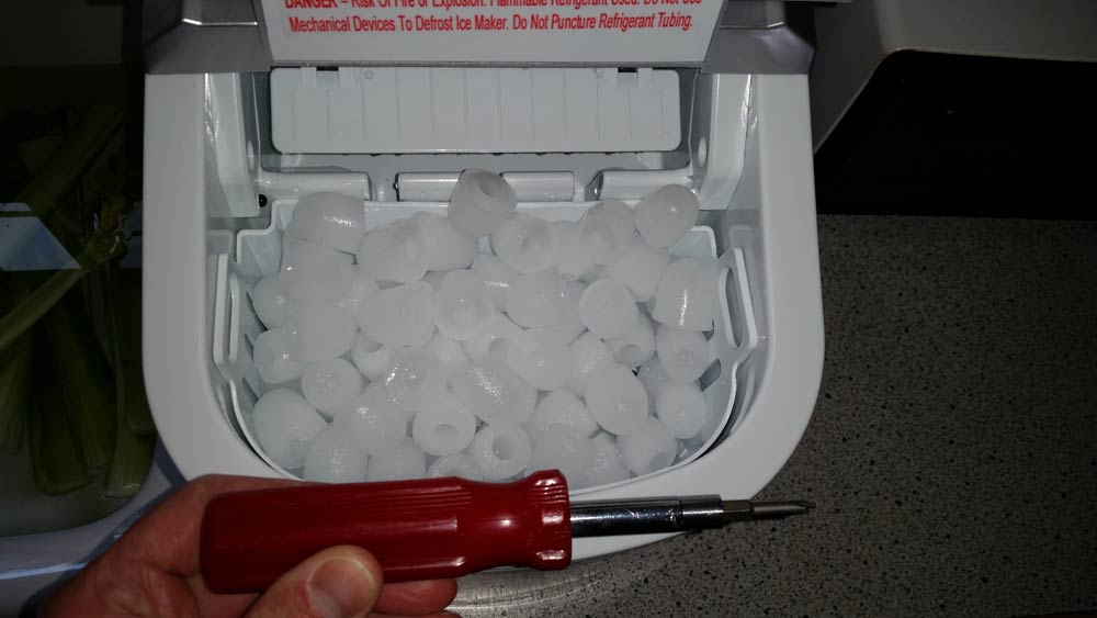

Tested it with the Killawatt, averages right around 100 watts while running (Killawatt showed exactly 200 watt hours over a 2 hour period). When the compressor kicks in I did see ~250 watts as a surge so you'd want an inverter that could handle that. When the power is on but it's not cooling (i.e. the ice bin is full) it pulls 3-4 watts... pleasantly when you turn the power off it appears to have no ghost load and shows 0 watts (although I don't know exactly how sensitive a Killawatt is).
It's not the quietest thing in the world but it's not too bad... measured with a smartphone app it was ~47db at 1 foot / 27db at 5 feet.
Cubes aren't like you'd get from your freezer ice maker or ice trays, but on the "large" setting they're decent sized... it filled its bin from scratch in right around 2 hours:
Ice maker bin
Overall I think it's going to be an economic way for us to make some ice and not use the freezer... we have a propane fridge/freezer combo but the freezer is pretty small, when we are at the cabin for a few weeks at a time we use all that space for frozen food and we don't have space to make ice so we're going to use this... mostly want ice in the afternoon / evening for drinks, figure run this for a few hours when our batteries are already topped off and it's free energy
