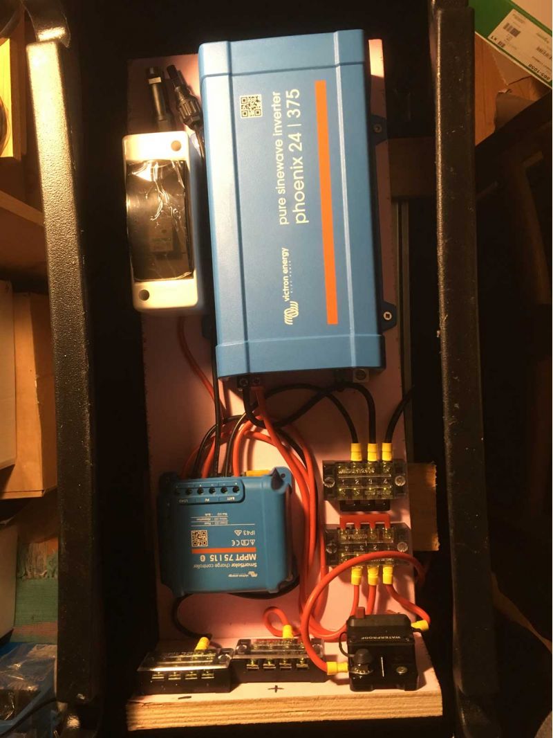

I sold a ski club a solar system recently.
This system has one solar panel, 1.5kwh of lithium battery storage (not seen as it is under the panel) and a 375w inverter for lights, tv, radio, device charging.
The system is in a big battery box as it is stored outdoors. It is critter proof. Well. More or less.
Note the 24v bus bars. The ski club is using 24v DC lights for the parking lot.
The solar controller and inverter are programmed so that neither the lights nor the inverter can over discharge the battery.
Should be good for a decade or two.

Ski club? What do you do to charge the battery below 32 degrees F? Does Victron let you tailor the charge profile to temperature or?

Looks sweet. Do you need grounding with a DC system? Can't tell from the photo.

There are lithium chemistries that have a wider charge/temperature range. LTO is down to -30C.
And even then, its can be about how hard you charge. Yes, That's one place programmable equipment like Victron can be useful.
Grounding is a contentious issue best approached carefully. I welcome your input on how you would bond this system.
I work with the DIY crowd. These folks have the skills to build safely. If you need detailed instructions you maybe don't have the necessary preparation for something like this. So I hesitate to be too specific. There are lots of good system builders out there. And the value proposition is there in spades.

Grounding/Bonding. Usually inverters are internally bonded since they are often used in vehicles or on their own. From my limited knowledge, you should not bond any system twice - but most are grounded with some sort of grounding rod or plate. I concur that this is a contentious issue and should be approached cautiously. There are previous discussions here about this. The manual is a great idea.

This is a really small system. So you should be able to follow the picture to build your own. The wiring does need to be very high strand. Its expensive. But "resistance is futile."
