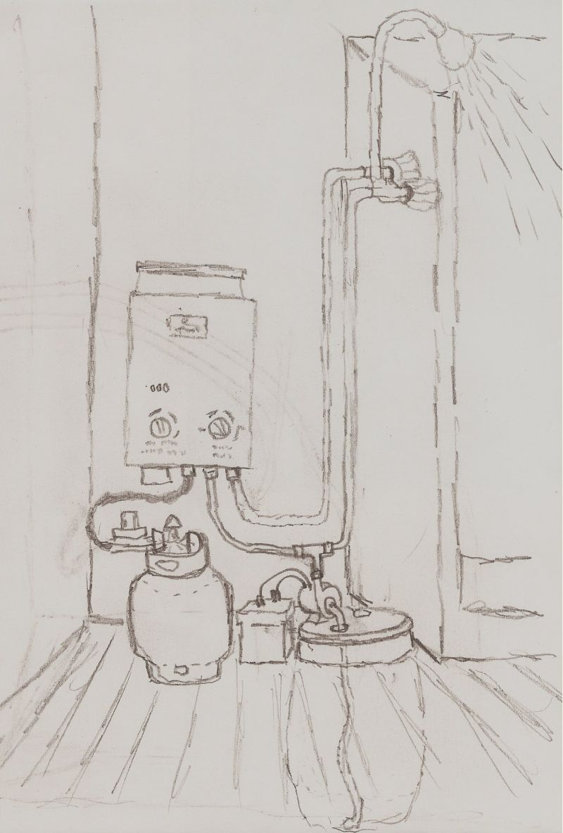

Howdy Avealic.If you can get your hands on two plastic barrels,you can bury one up to the rim or a couple inches left above grade.Build your shower building over it leaving it in the corner.get yourself a sure flo 12 volt RV water pump.(JC Whitney)Hook the inlet to a 4 foot hose,dropping that into the barrel.hook the outlet to an L5 portable on demand (20 lbs LP gas) water heater.(Ebay)the output of that to the hot water side of your faucet to your shower .Also a line to the cold water side of the shower faucet.It will give you 55 gallons of hot water on demand.I know it's easier said then done.You'll need a charged up 12 volt battery to run the pump.Somthing to charge the battery,be it your truck or solar or your generator.If your setup is in freezing temps,you'll have to pull the pump and heater and take it indoors when not in use.You can hall the barrel of fresh water up there on your truck,sifon it out to your barried tank.(gravatationaly).If you use 1/2 the water or more befor you leave it for the winter,it shouldn't hurt anything.

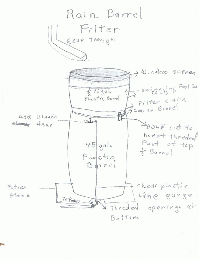

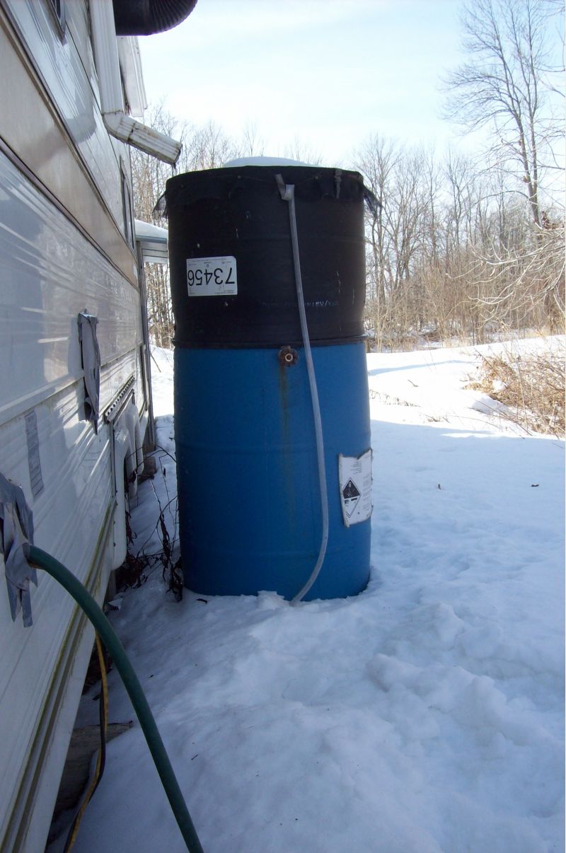

You could try burying a plastic tank {i would gess 25 gal. per man per week} put a 110 v submersiable pump in it {50$} plumb that to your shower shelter with a garden hose >> buy a used propane water heater from a used trailer parts place[50$] that will heat the water + heat the shelter .. put in a set of taps unhook the garden hose when not in use ,, hook the tank to a eve trought if you have one.. i have one that hooks to my place for three seasons only[piic]
rain water all we need
how it works
how it works

Can you expand a little bit more on your filter system with the gravel and cloth filter. How much gravel and what do you use for the cloth filter. Where is it placed. How much bleach. I noticed your barrel is out in the snow. How do you keep it from freezing?
Thanks so much
Vance.
# Posted: 26 Feb 2011 09:36am
4 in of gravel ,for filter cloth i used a 100% polyester my wife gave me from her stash, but you could use some fiberglass if you con find some bleach 1\4 cup a week make sure it is simple cloren bleach
i have a tap in the top of the bottom tank were i add the cloren into the filterd water it is very clean ,.we empty the system every fall after deer season, don't use in winter but if it were under ground i can't see way you could not !!
# Posted: 26 Feb 2011 07:46pm
i gess i was'ent clear 4 in of gravel in the bottom of the 1\2 barrel then the cloth then the swimming pool filter sand 50 lb.. then the window screen to keep out the big stuff.. i have a 12 v . trailer pump but i am not sure it would suck out of a buryed tank !!

thank you Just. Couple more questions. Not familiar wiith swimming pool filters. What type? Also just put 50lbs of sand(any specaial kind) on top of the filter and rock.
Aveallc
# Posted: 27 Feb 2011 09:25am
Me again Just. can you explain the process for attaching the 2 tanks together. What size hole and pipe from one to the other?

Aveallc
any kind of course clean sand will do morter sand from the lumber yard or swimming pool sand from a pool store . iused lake Erie beech sand..!!
# Posted: 27 Feb 2011 05:02pm
Aveallc
bottom tank is blaced up side down ,threads at the bottom ..
attach hose to small hole ,plug large hole !!
cut top tank in half , discard bottom half , plug small hole i n other half , put a 2 in. hose fitting in large hole , place half tank on water tank and mark were there needs to be a hole cut to allow the 2 in. fitting to extend into the bottom tank, cut hole and place half tank on water tank ...then posision the two tanks in there perminant spot !!
then put in the 4 in. grevel ,, the filter cloth ,,,the 50 lb. of sand ,and the window screen ,, let it rain , hook up up your pump !!!

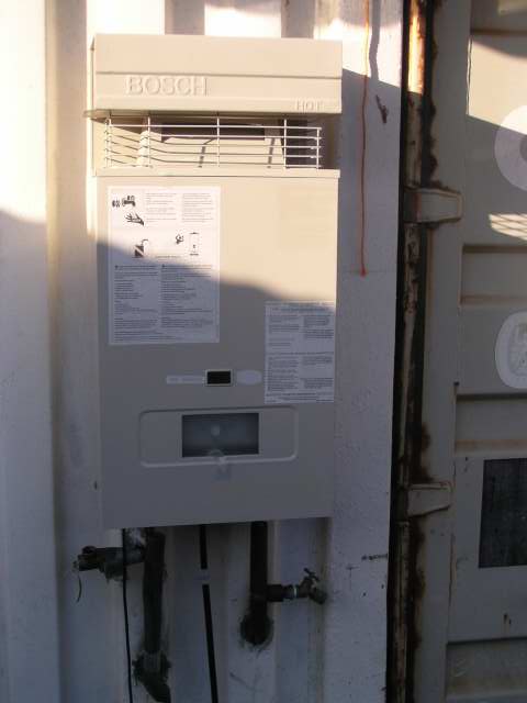

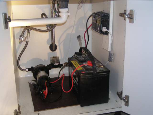

Here's what I do.
I have a 300gal blue plastic tank on a trailer that I tow to the well that is about 1/2 mile away. The trailer is parked next to my cabin and connected with a garden hose quick connect to a short length of 3/4" water line that runs through the side of the cabin and under my kitchen sink. There it connects to a 12v variable speed pump that maintains water pressure in my system.
The system runs the water through an on demand propane water heater hanging on the outside of my cabin. The water heater uses the pressure of the water to spin an ignitor to light the heater whenever you turn on the hot water faucet or the shower.
I installed an actual full sized shower from home depot with a super saver shower head and viola.

I made my shower in a previous cabin like this. Build a shelf in the bathroom for a 5 gallon bucket. In the bucket, I put a small bilge pump from a boat. The pump take a 3/4 inch hose, which is connected to a shower head. The pump is connected to a 12 volt battery, and I put a switch in the shower. Warm your water on the stove and pour in the bucket. Jump in the shower, turn on the switch and the bilge pump starts up and you have a nice refreshing shower. You may have to drill a bigger hole in the shower head to help with the pressure.

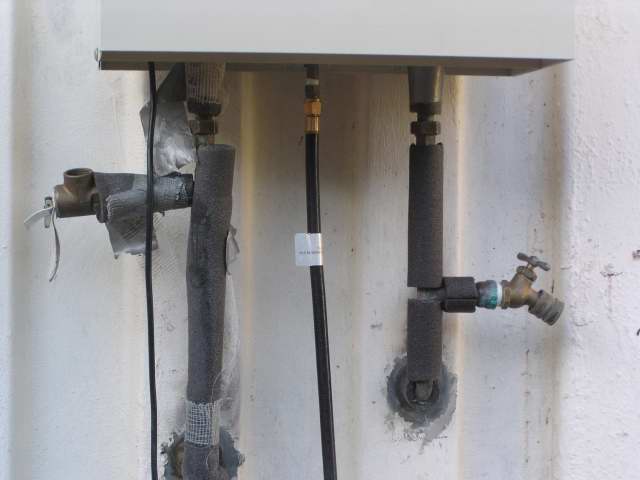

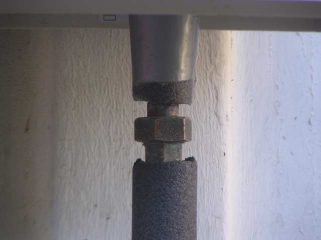

My on demand heater is a "Bosch" brand and even though it doesn't need any electricity at all to operate normally, it does have an electrical cord on it to power several heaters inside the system to prevent freezing. Unfortunatlely, I turn my power off at 10pm, so I just take it off wall and bring it inside when there is danger of freezing. If you set it up right, it takes less than 2minutes.
hebegbz
# Posted: 3 Mar 2011 11:59pm
Here's a couple of pics of the water heater hook-up on the back of my cabin, and the way the water comes in under the kitchen sink.
