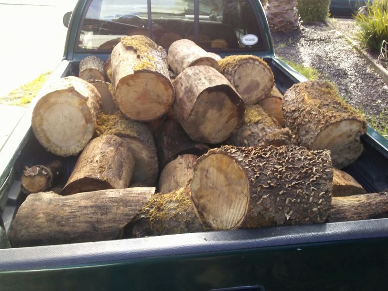

Scored some free rounds yesterday, not enough that I want to drag my hibernating gas splitter out. I'm getting through it with the freshly sharpened 10lb. maul but looking for tips to ease my tired old back. The previous load I had split I noticed was best done by hitting parallel with the growth rings a bit away from center until the round was first split. This stuff is pretty dried and hard.

You didn't mention the type of wood, that you acquired. different species some times split differently. If it is dead elm that they appear to be . That can be a problem. I would lay the blocks down and rip them into night blocks that would fit through the door of your stove. Smaller stuff I would leave it round . It appears quite dozy and damp so pile it and don't try to burn it until it dries out. I have cut and burned lots of dead elm, a lot of the ones on my farm have been dying. Others especially maple or beech , stand them up, always split from the top , like it was in the tree. work from the outside in. Or rent or borrow a splitter. have fun old243
