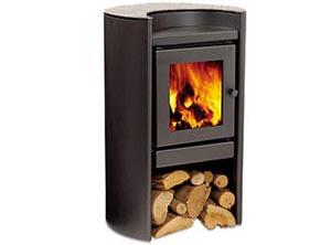

We will be installing the Amesti r450 stove in spring. It is made in Chile. We got it on a super sale. Cabin size is 12'x15'. It is the smallest EPA stove we could find at a store, and far cheaper than a Jotul. It is rated for up to 600sq ft. Our concern will be to control heat, as the space is very small. Do you think if we installed the double-wall insulated pipe right from the base of the stove, that it could reduce the amount of heat output? I know normally you just use single wall until you reach just near the ceiling, then use double wall for safety. Our ceiling is low so we would only end up buying one extra section of insulated pipe in place of single. Any ideas.

Neat looking stove.

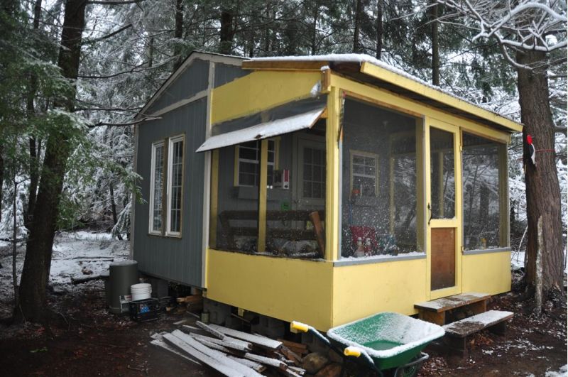

Spee, we have used a Buddy propane heater from Princess Auto. The thing smells, and only provides heat in the immediate area above it. It warmed our cabin a little 2 weekends ago when it was -18 C outside. We turned it off minutes before going to sleep. Let's just say it was so cold, I had to peel the plastic off the water bottles that had turned into solid blocks of ice so I could make coffee in the morning. Propane sucks. We do have a 12x8 with a 12x7 porch, so we think we will just open the door when it gets hot, maybe even put up temporary walls on the porch so we can sit there all toasty too. My main concern is to keep the cabin safe and not cause a fire. The stove is actually tall, and not that wide. I'm happy to trade space and gain comfort. I believe it won't take up too much room. And we did buy it at 75% off, which is about the price of a tent stove these days. I'll post about it when we install it this spring. Let me know what you decide to do for your cabin.

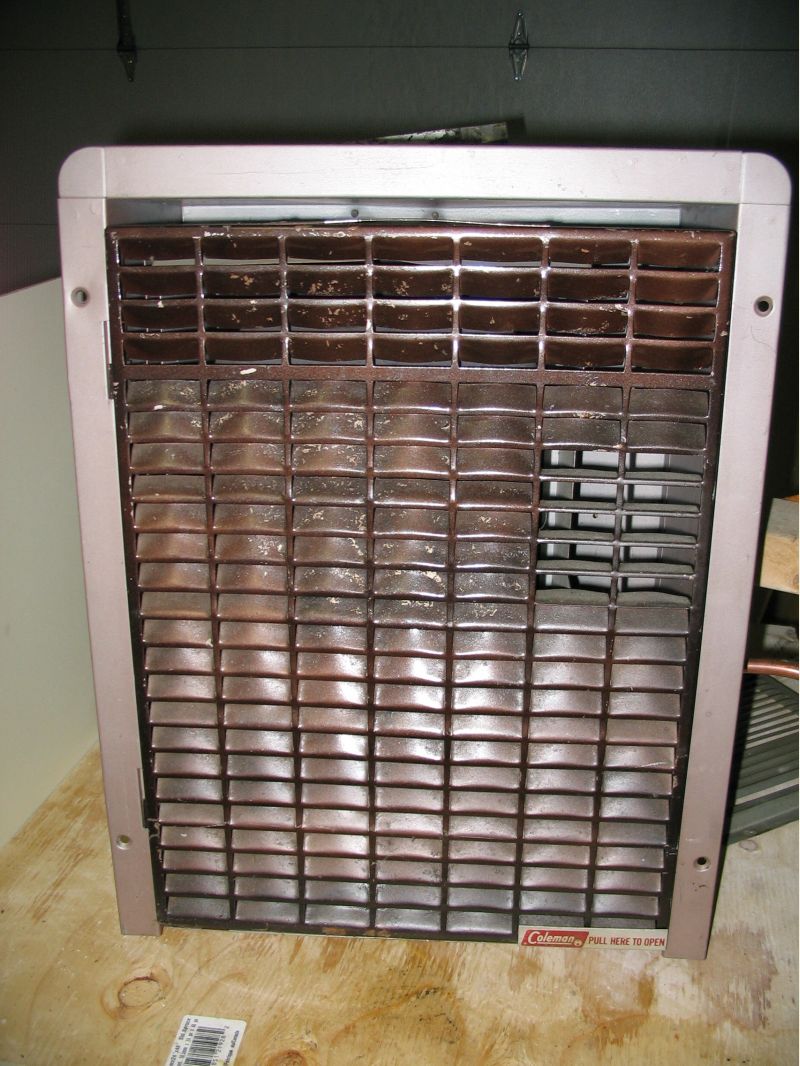

BB, Our bunkie is 10' x 10' and 14' high...the loft is 6' to the peak and the bunkie is insulated. I'm installing a vented 10000BTU propane gravity furnace from an RV (no electricity required). Had it reconditioned....blue flame...works great...has a thermostat...really kicks out the heat. Problem with the woodstove, in my situation, is that it's me, my wife, two boys and a Lab in the bunkie...a hot stove would be too dangerous and too hot in general. Now, if it was just my wife and I...I would seriously think about a tiny woodstove. The one you found looks cool...what are the dimensions? salvaged RV furnace
|  salvaged RV furnace

I wonder if we should have just insulated the shed and gotten the big buddy. It would actually cost us more to do that than to buy the stove and pipe. Just wondering.

That sure is a sweet lookin little stove.

Quoting: Barrys Bay We will be installing the Amesti r450 stove in spring That is a nice looking stove!! Might I ask where you bought it?
Barrys Bay
# Posted: 5 Mar 2011 11:31am
Lowe's. It was regular $599, got it for $150 at 75% off.

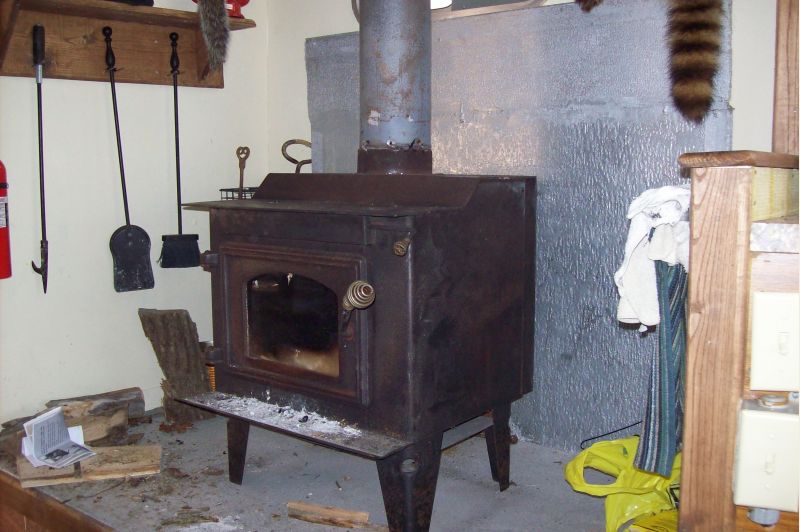

first year heating with wood and i'm putting in propane on the positive side: i have bowling ball biceps and my forearms look like they're about to give birth to a squirrel. on the other hand i found out i am pron.e to choppers elbow. it hurts to lift a beer. tho using my left hand is good for the ambidexterity. like groingo i use smaller pieces of wood and i have an older stove, so i can adjust the air going in and damp down the fire. you get pretty good at adjusting the air. -10 last night with no problems. my cabin is 12x20. with R25 insulation
