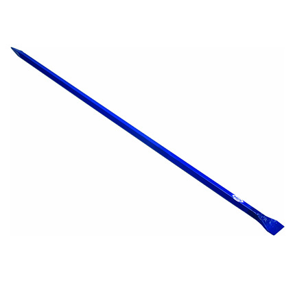

I'd strongly suggest adding a steel digging bar to your arsenal. A 5-6ft one, pointed on one end and a chisel on the other. Pick it up and let it drop under its own weight and then pry to loosen up the rocks. As your hole gets deeper, it works better than a pickaxe.

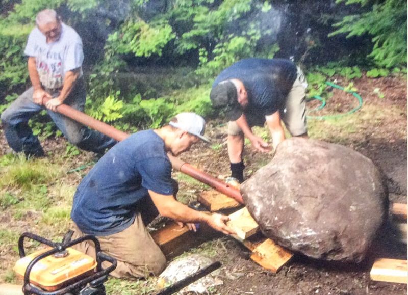

Hope you don't run into this issue.
This rock looked so small until we started digging, lol.
Had to move it to build our deck ramp.
If you have a lever long enough....
