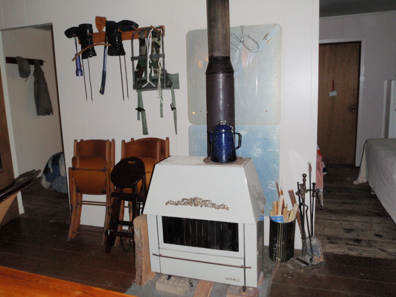

# Posted: 4 May 2019 09:04pm
Here's a pic of the woodstove we have, I think i was made in the 70s...
