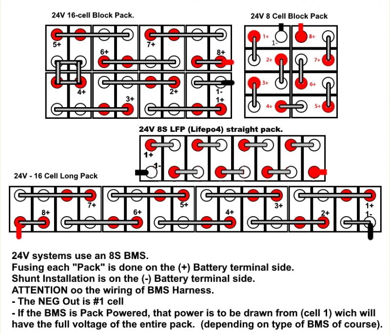

Well, I am about to decomission my FLA (856AH gross) in favour of 910AH LFP (LiFePo4). Maybe some info here will help others see the LFP options now available.
I built two 24V/280AH 8S "Block Format" packs and two 24V/175AH 8S straight packs.
The final rendition of the summer long build experiements came out as such:
Each pack has a Chargery BMS8T-300 BMS with 300A shunt, 300A DCC (Solid State Contactor). Each pack will have a QNBBM 8S Active Balancer as well, as these larger capacity cells tend to wander much more.
To determine kWh, take simple this example: 100AH battery X 12 Volts = 1200Wh or 1.2kWh 100AH battery X 14.2V = 1420Wh or 1.4kWh
September Sales Special on Alibaba has also presented some amazing deals on LFP Cells. Couple of highlights: Grade-A EVE cells. 8 Pcs 3.2V 280Ah = $891.44 USD * 8 Pcs 3.2V 120Ah = $568.02 USD * * = Delivered DDP (Duty Taxes Paid) LINK to Vendor (Luyuan Tech) https://szluyuan.en.alibaba.com/productlist.html
Chargery BMS8T: http://chargery.com/BMS8T.asp Chargery DCC on main page http://chargery.com/ DCC Manual Link (PDF): http://chargery.com/doc/Chargery%20DC%20contactor%20manual%20V1.0.pdf
DeliGreen QNBBM Active Balancer: https://www.alibaba.com/product-detail/8S-LiFepo4-Lithium-Lipo-LTO-Battery_1600103959 074.html
Are LFP batteries safe or not ? https://www.youtube.com/watch?v=Qzt9RZ0FQyM
Typical 24V 8S configurations:
