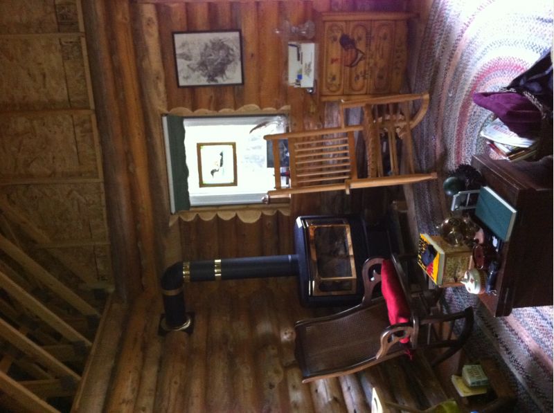

We are in Ontario, Canada. Here is a photo of our propane stove. We couldn't get insured using wood. It looks so good. A few people thought it was wood burning.
Since you won't be needing to heat much. You won't be going through to much propane. We could not get a propane company to come down our bush road. So we couldn't get 100 lb tanks. We use 30's. I can manage to lift those. We had to spend part of Nov up at the cabin. It was really cold and snowing. We used one 30 a day! Our cabin is 1,200 sq feet and insulated with spray foam.
This of course is not economical. But that was also using the propane stove, baking a lot and a propane refrigerator. If your not there in Nov than you won't need to use it that much. I think you might need to use heat a little in October. In Oct our tank lasted a week because it would be cool in the morning ( turn the stove on for about 20 minutes) and heat up during the day.
We use a down comforter at night so it was comfortable to sleep. I had a thermostat remote control set up and bought a gas stove fan ( the fan that sits on the top of the stove vent and runs off the heat) from Amazon. Off grid and it works beautifully. Easy. That's what we're looking for. We're older now and want to be able to enjoy our cabin as long as possible.
