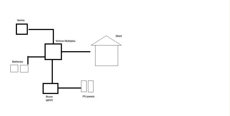

mj1angier
# Posted: 20 Jun 2019 11:38am
Quoting: creeky
I would also consider moving up to 24v
The Rover Li 40A MPPT Charge is 12/24 and I can get the branch conectors to run the panels in 24v set up.
That would put me getting this Victron unit:
https://www.amazon.com/Victron-Energy-MultiPlus-Inverter-Charger/dp/B00RPOYF50/ref=sr _1_6?keywords=Victron+Multiplus&qid=1561044336&s=electronics&sr=1-6
Is this the correct layout:
mj1angier
# Posted: 20 Jun 2019 11:48am
I am trying to get the "heart" of the set in higher quality items and also have room to expand later- more panels and batteries.
The ac will be biggest draw to start but would like to add a smaller refrigerator later.
It's not the greatest place for solar- too many trees. But if it can charge up or top off the battries during the week, and have genny to boost it on weekends, I hope to get by. The genny can run 3-4 hrs during the day, but not at night unless it is just to hot to live, lol
# Posted: 21 Jun 2019 09:37am
Your diagram looks good.
The higher your panel voltage the easier it is to run the panels further from the house. I've put panels hundreds of feet away to get good sun.
Remember the MPPT will take the higher voltage and convert it to the battery voltage with very little loss.
Good luck.
