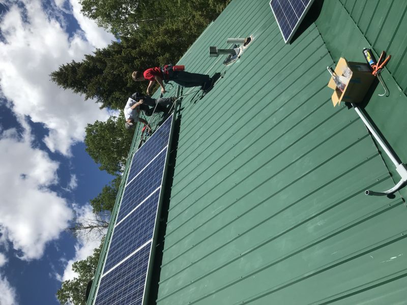

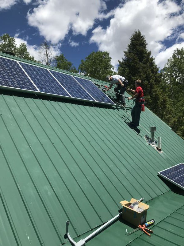

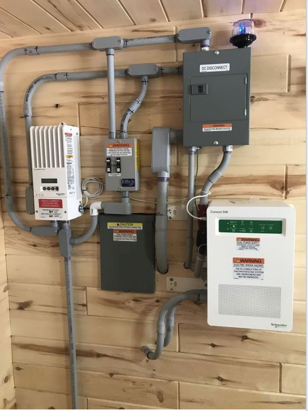

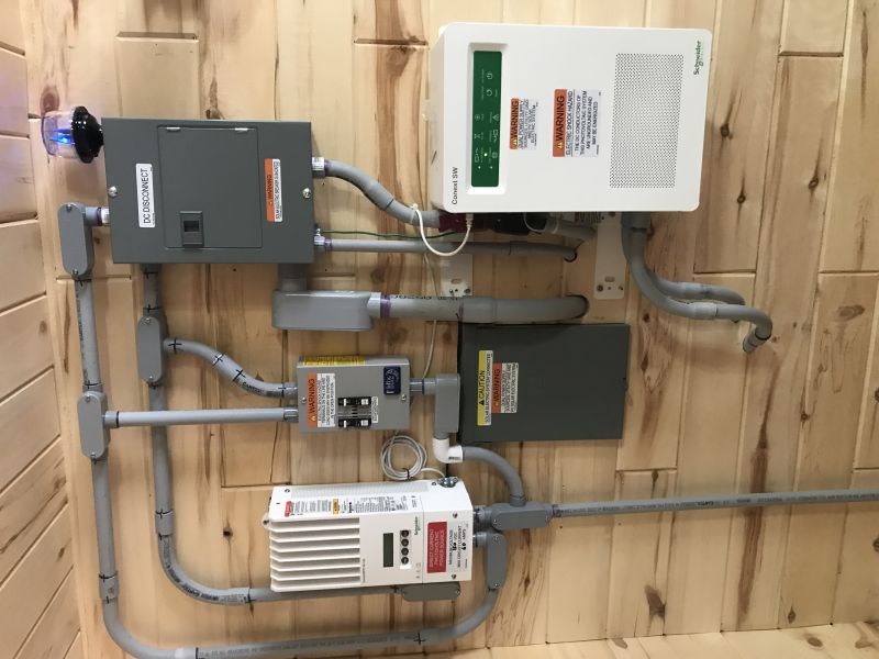

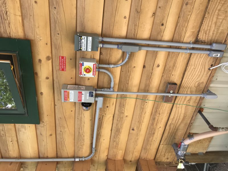

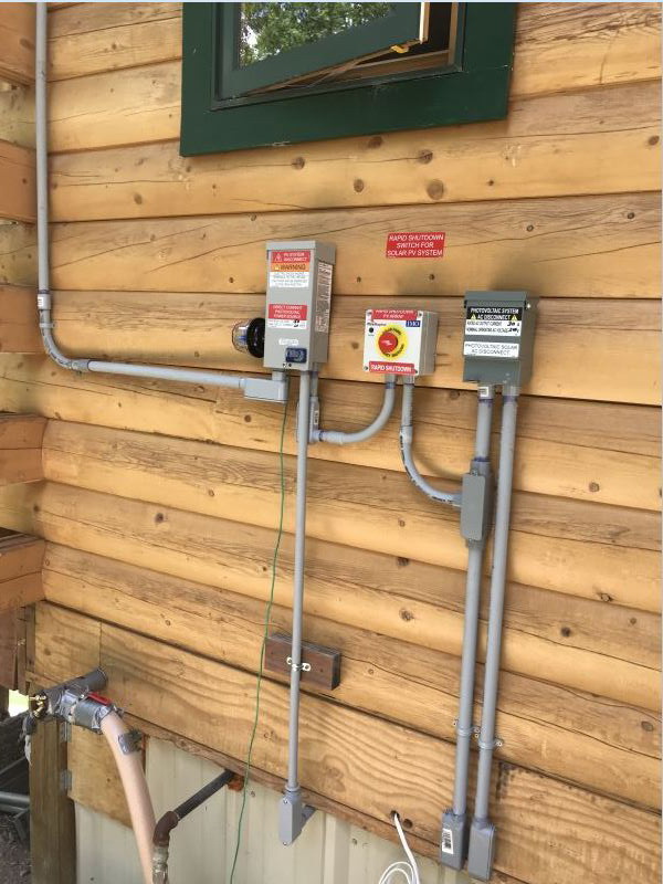

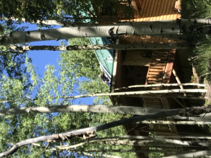

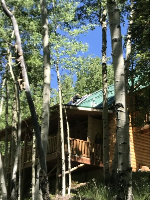

# Posted: 29 Jun 2019 07:44am
Thanks for the votes of confidence! I’m new to this full house solar so am still stumbling through. My thinking with the oversized array was I could always add storage if needed but getting up on the roof is not for an older one armed man. Son in law and grandson put the panels up.
Here’s some pictures though since I’m posting from my phone pretty sure they will be sideways.

# Posted: 29 Jun 2019 10:43am
Rotated
# Posted: 29 Jun 2019 12:10pm
Wilbour.... thanks for the “rotations!” Don’t know why iPhones always post pics sideways.
