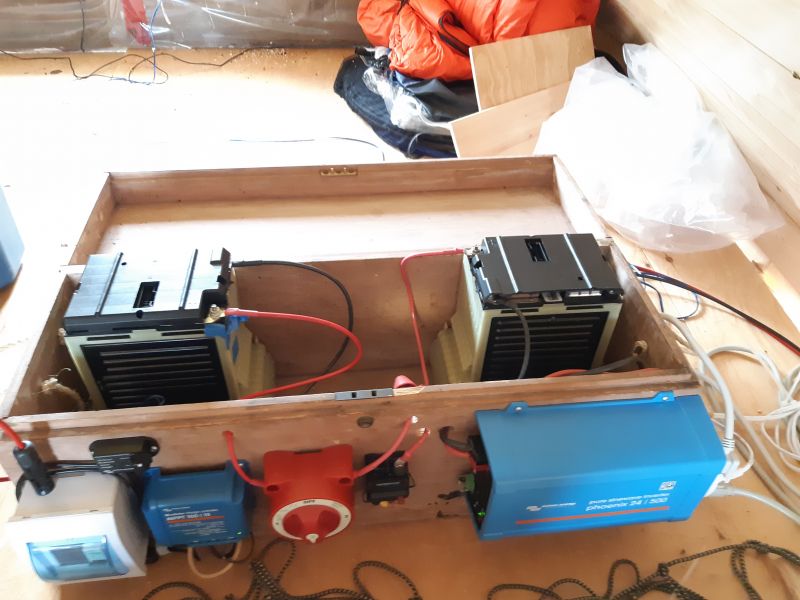

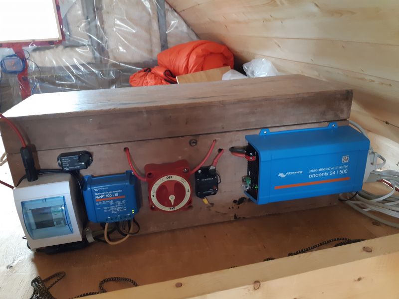

Check out my simple setup:
http://www.small-cabin.com/forum/3_8226_0.html
I run a small fridge with freezer built in. Charge my cordless tools, cell phone, laptop. Run 3 indoor led lights and 3 outdoor LEDs.
Yes you can buy quality stuff and take it with you as you upgrade (to a point).

If you follow my thread the end product was below $2000. I believe you may even be able to get it below that now.
Final specs were 2kw Lithium + 1 285w panel + 500w inverter + 100/15 charge controller. Plus all the fixin's.
That's up and running
