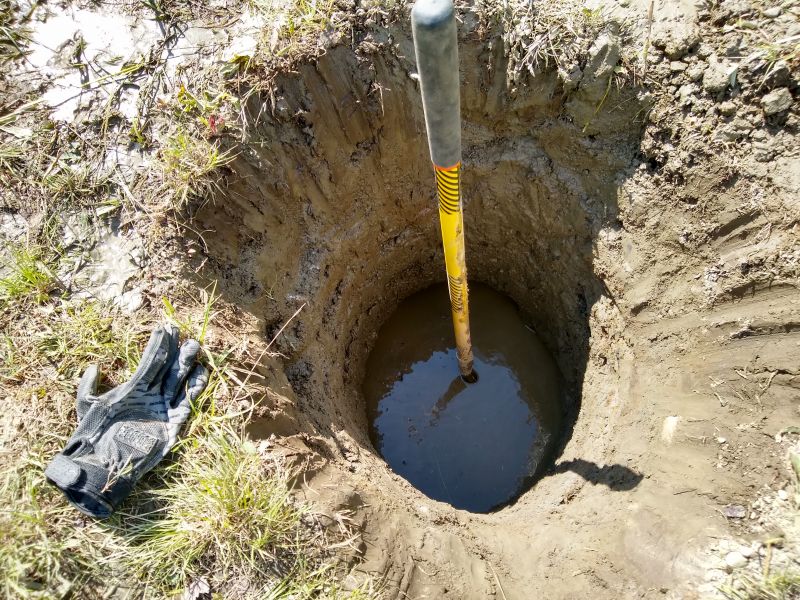

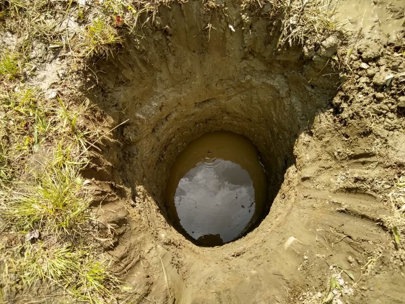

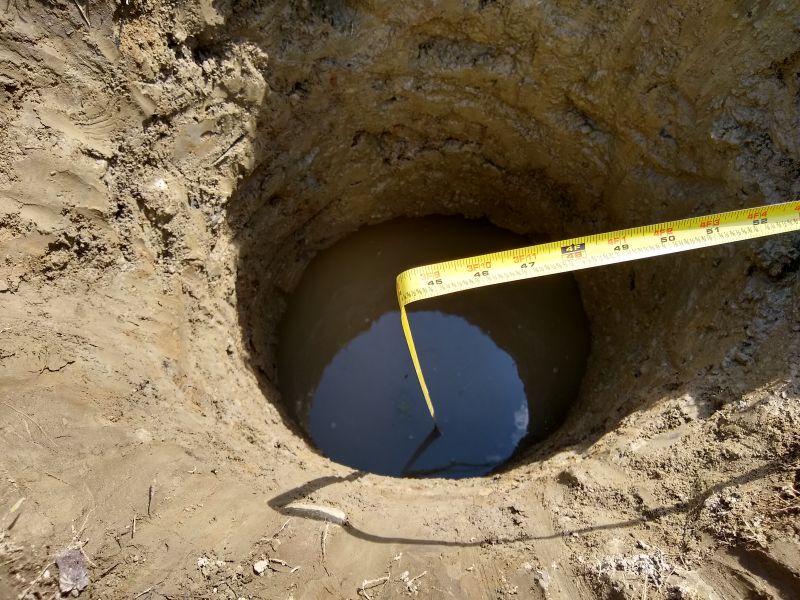

So at just over 4' I hit water, a lot of water, it flowed it. I scooped it all out and it filled right back up. I then left to go to the hardware store to get a post-hole digger since it was getting too deep for my shovel. came back and the water level is higher then when I first hit water. threes a good foot or so of water and it seems to flow in as soon as I remove any.
Is it possible I hit a vein of a spring? I'm wondering If this were to be a spring how do I proceeded?

Sounds like you just dug a well. Make a cap for it and put on a hand pump!
With our regs a septic or pit needs to be a min. of 50' from a well, preferably more. Pick a new spot? Dig, see whatcha find. If you keep hitting water you are likely going to need a holding tank rather than contaminating the ground water supply for you and the neighbors.
Definitely more research into doing a pit safely is needed on your site.
