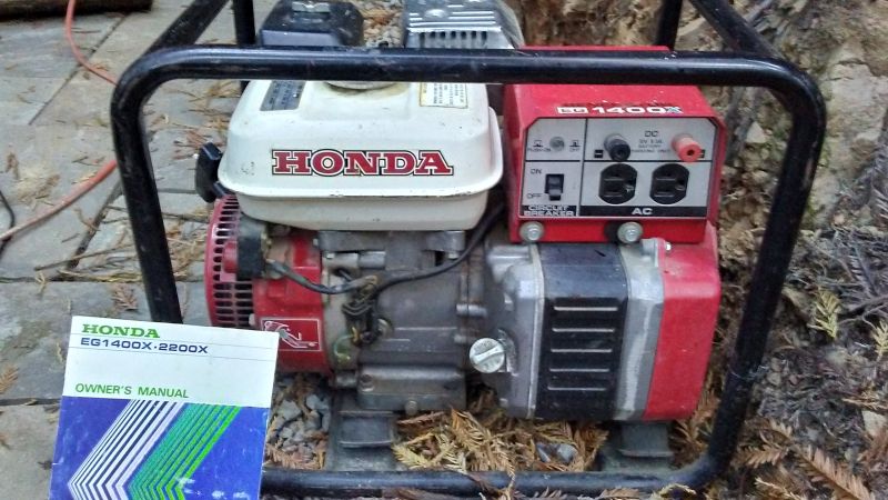

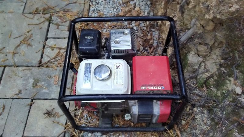

# Posted: 16 Sep 2019 06:30pm - Edited by: paulz
Just bought this old Honda off a pal to use in the carport I'm building 300' from the cabin. Runs great, kinda heavy for 1,400 watts. Probably pretty rugged I'm thinking. 1986 model. Anyone remember these dinosaurs?
AffordableDCGenerators
# Posted: 16 Sep 2019 07:45pm
Nice vintage genny
Any other photos?
# Posted: 16 Sep 2019 09:27pm
Just realized it has a built in 12v charger, hooked it into my battery bank. I guess they all have that.
