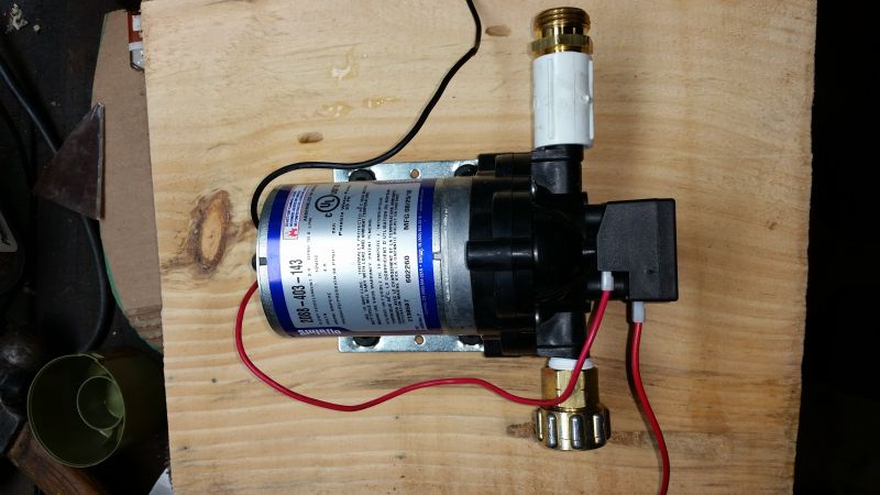

Rickkrus
# Posted: 9 Aug 2019 01:13am
Bought a Shurflo 2088. Will this have enough power to lift water four feet into a pressure tank?

# Posted: 10 Aug 2019 09:15am
Nice tip Steve.
I'm using Shurflo. My biggest beef is the pre-filter. They are hard to get sealed. The pre-filter screen thing basically lasts two years if you're lucky and then start to leak air. It is very very annoying.
I buy them two at a time now. And ditto with the plastic threads.
