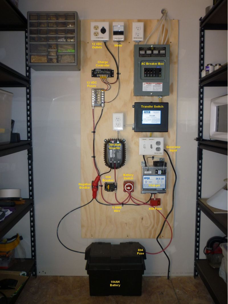

2 grand for grid power is a bargain in the long run. I'm greater than 1/2 mile from the nearest line, and it would cost me 15-20K to get hooked up. So, I'm in the process of installing a solar power system that will end up costing about 2K. I could probably do it for less, but I've bought some nice components so I can increase my capacity over time.
At it's current capacity, I figure I can consume about 400 watt hours per day - which is not very much. Also, I will still need to bring my generator up when I have to run power tools for any construction projects.
Power System
Power System

Steve, that's a nice little solar setup you have there. Good info on that Morningstar inverter
