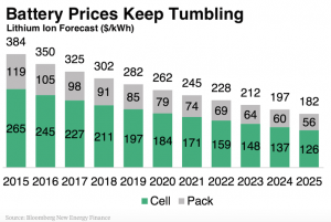

As far as prices, the articles I've read predict a slow decline
